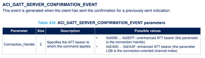

If what you are looking for is some kind of event telling the CPU1 that the ACK from the client has been received, you can add the ACI_GATT_SERVER_CONFIRMATION_VSECT_CODE in the switch case of the function
static SVCCTL_EvtAckStatus_t Custom_STM_Event_Handler(void *Event){} (if you are using the CubeMX BLE custom option) between the user code comments
/* USER CODE BEGIN BLECORE_EVT */
/* USER CODE END BLECORE_EVT */
Description of the event in the AN5270
Hope this works as it worked for me.
