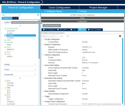

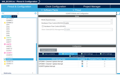

2025-03-15 7:44 PM
I am using Nucleo-H563ZI in this. I was configuring USART6 in DMA mode, but for this controller instead of DMA, there was GPDMA1/2. Currently, I have configured it in GPDMA1. The module is EC200. I am transmitting AT but am not getting the response that it is OK. Therefore, I am not sure whether the USART is correctly configured or not

Try to enable FIFO mode on USART.
2025-03-17 1:30 AM
Hi @Shubham08
You could also try to declare isSent variable as volatile (as used in both main and interrupt routines). Depending on your code optimizations options, it could help.
Another comment : in your code your mentioned COM_WORDLENGTH_8B : 8B is nb of data + parity, so as no parity check is enabled, it means 8B data, not 7 (nb of stop bits is not part of Wordlength.
regards
