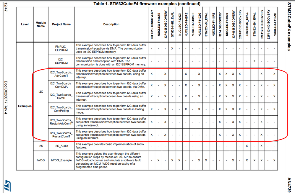

Have you tried any of the provided I2C examples:
https://github.com/STMicroelectronics/STM32CubeF4/tree/master/Projects/STM32446E-Nucleo/Examples/I2C

Thank you for those samples. I am new, I have not tried those samples yet. I will try now.

I actually solved the problem. The examples helped me a lot. Thank you.
