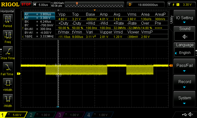

Iam trying to setup SPI1 on STM32WB nucluo (STM32WB55RGVx), I made a configuration trough the STM cube and do some adjustments, the problem is that in every sequence iam trying to transmit with HAL_SPI_Transmit is a gap for couple of microseconds. Then the sequence follows normally.
Firstly i thought, that the problem is caused by RTOS since i use the mbed, but when the issue was not resolved even if i configured transmit over DMA. Is there any chance that this is the problem of SPI or clock configuration?

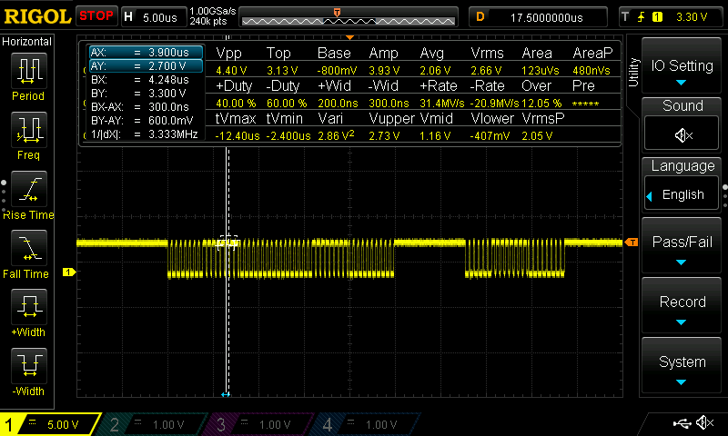

Do you see the same gap if you observe SCK?

yes, there is the same gap as on MOSI pin

Is this with using DMA?
2020-02-13 1:56 PM
I have tried Transmit with DMA and also just simple Transmit, both work the same. Also i have tried to disable all interrupts during transmit, but it does not help.
2020-02-13 6:13 PM
- start a new project with only the SPI Tx using DMA, and observe
- try a different SPI channel, again with DMA
