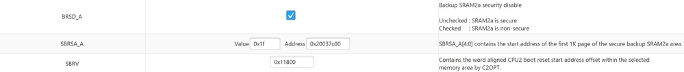

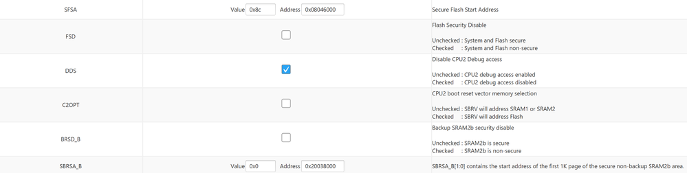

2023-05-19 12:53 AM
2023-05-22 1:39 AM
Can you share the option bytes values of your board?
Best Regards

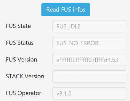

2023-05-22 3:00 AM - edited 2023-11-20 5:48 AM
In this scenario, FUS version is different from 0.0.0.
In first, there is version number like this, after I try to recover it, it changes to 0.0.0.
Do you need other option bytes?
2023-05-22 5:08 AM
According to SBRV option bytes value, the FUS is not running, you should start the FUS before reading the version. Can you add a screenshot of ESE option bytes?
Best Regards

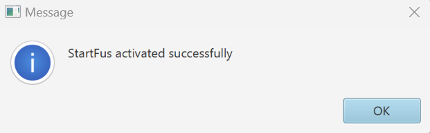

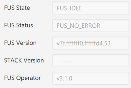

2023-05-22 5:24 AM - edited 2023-11-20 5:48 AM
ESE is checked.
When I press Start FUS on STM32CubeProgrammer, it shows me
And after I press Read FUS infos, it shows me following info, and SBRV is 0x11800.
2023-05-22 5:26 AM
In my previous message, FUS version is different from in new message.
I think there is a problem about FUS, so I want you to send me FUS binary file.
2023-05-22 6:34 AM
In my previous I made a mistake, SBRV at 0x11800 indicate that the FUS is running. Unfortunately, I can't share a FUS binary file. Which version of STM32CubeProgrammer tool are you using? And which interface are you using to connect board?
