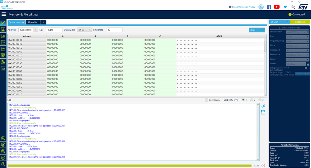

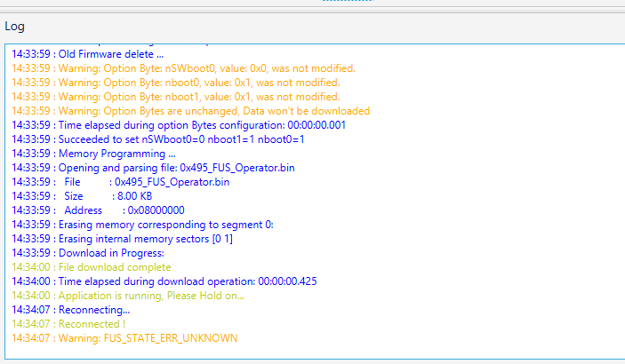

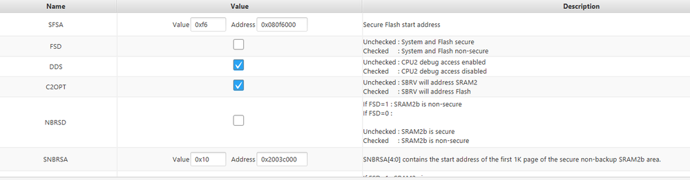

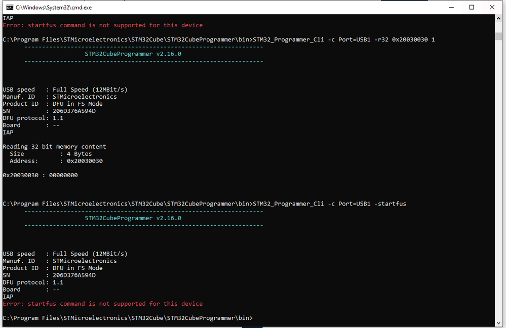

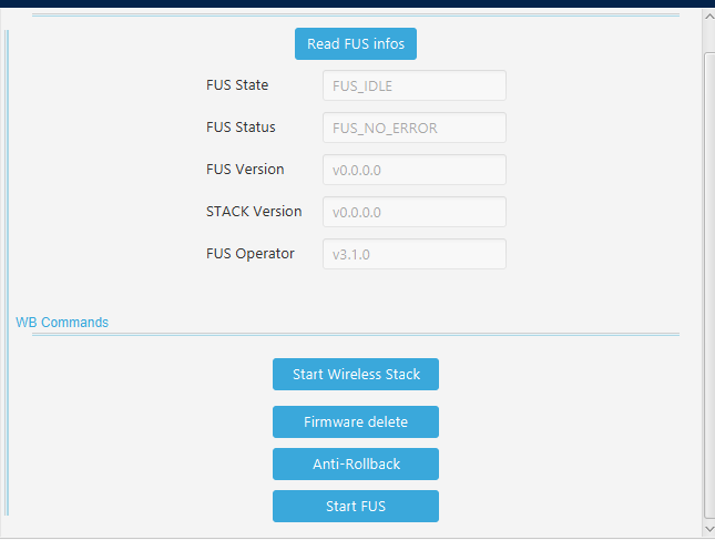

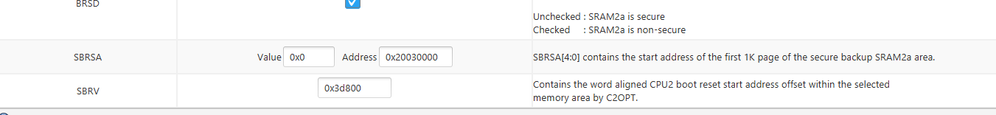

I then used the ST-Link to try to perform the update, but encountered these errors:
You can also find some informations related to the dongle.

Hello @Marshall08
According to your screenshot, SBRV is equal to 0x3D800 that indicate FUS v0.5.3 is running on your board. So, you must update the FUS using the stm32wb5x_FUS_fw_for_fus_0_5_3.bin binary.
Best Regards.
