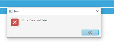

In one moment I lost connection between MCU and ST-link(The interface firmware FAILED to reset/halt the target MCU) but I managed to fix it with connecting BOOT0 and VDD. After that I couldn't even read memory:

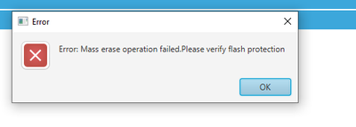

This happens when I try mass erase:

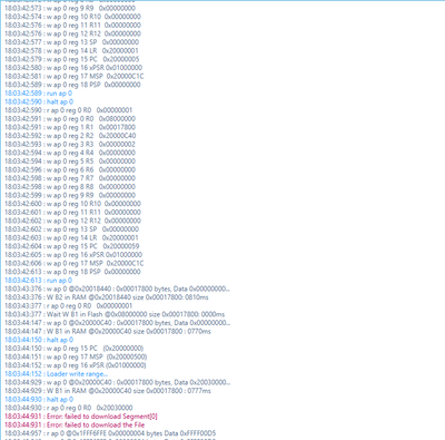

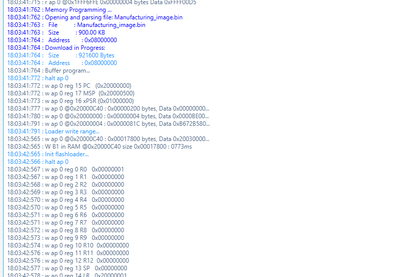

These are some messages when I try to flash:

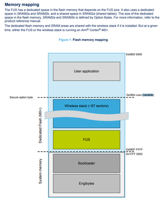

After investigation, the Errors when trying to flash the image are normal behavior since you are trying to use almost all of the memory, and in STM32WB5 not all the flash memory is accessible by the user, it contains both User application + FUS & Stack.
To determine the limit of the flash memory available for your application, you can check the SFSA option byte, which refers to the start address of the installed stack, or by clicking the "Read All" (under read) using GUI.
For more information you can refer to the application note AN5185 & the reference manual RM0434.

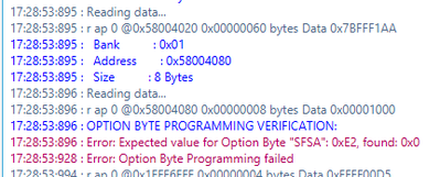

2024-10-16 8:32 AM
Thanks for clarification.

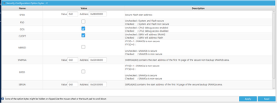

When I try reading of sfsa it is set to 0x00.
Can you try to set SFSA byte to 0xE2 on your side. When I try, I get error: Option byte programming failed:
Do I need to set some other option so this one can be set?
These are my default settings:
Thanks.
2024-10-16 8:51 AM
Hello @zax
If SFSA=0x00 that means Safeboot has been triggered.Safeboot is triggered due to a corruption on the FUS operation or memory.The corruption might be on Flash memory or on the process.
On the process means FUS was interrupted by forced Reset or Power off.
On the memory means secure memory flash has been corrupted physically (it can be due to forced reset/power off during operations or due to CM4 interference on Flash while FUs is using it or due to other factors related to physical flash (flash failure, voltage instability...)). The Safeboot is triggered by HW. Safeboot mission is to fix the error if possible and perform a factory reset to the chip (erase any Wireless stack present, reset FUS state to default and reset Option bytes values to default). If the issue is related to flash ECC error (double ECC error) in the secure memory area, then Safeboot is not able to fix it and the chip is blocked forever (no recovery is possible).
Best Regards.
