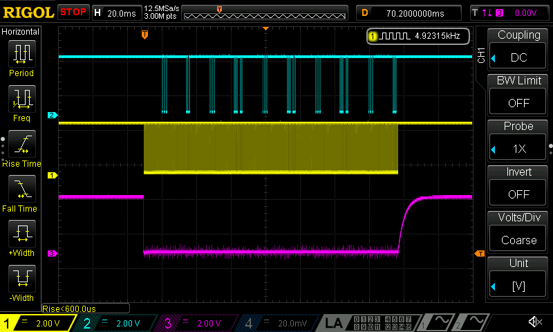

Not sure if I bricked it or zapped it, but it fails to flash (st-link doesn't work, USB doesn't work)...
08:48:52 : ST-LINK FW : V2J37M26
08:48:52 : Board : P-NUCLEO-WB55
08:48:52 : Voltage : 3.21V
08:48:52 : Error: No STM32 target found!It worked out-of-the-box, I tried to flash an example and then ... just silence.
Is it possible to brick it? If so, can I unbrick it? :D
L.E:
I just checked and the NRST, SWCLK and SWDIO on STM32WB55 pins (removed the rf shield). With other STM32 chips when under the reset the MCU was recoverable no matter the user settings was for the GPIOs.
Thanks
