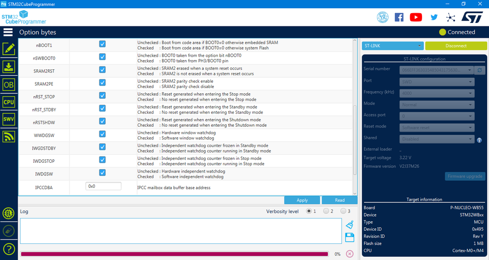

Hi everybody, yesterday I was working with my Nucleo68 board of the P-NUCLEO-WB55 pack as always, however something go wrong after to did this:

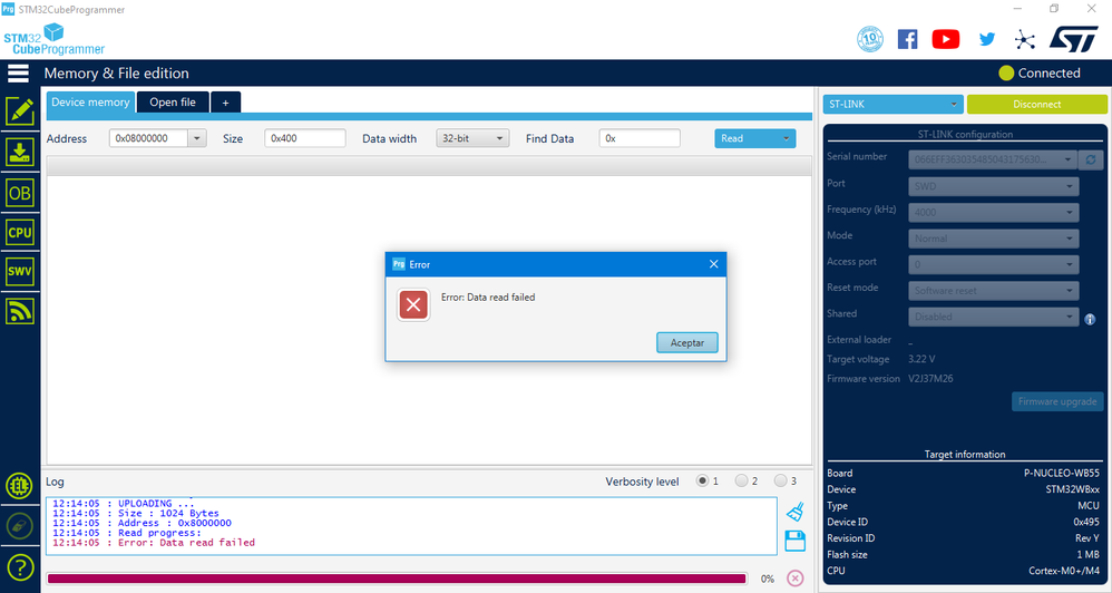

I can't read any page of the flash:

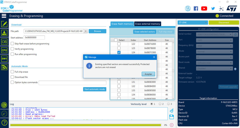

I guess that I can erase flash because apears the following message when I erase a sector:

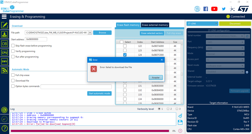

But when I download a file this failed:

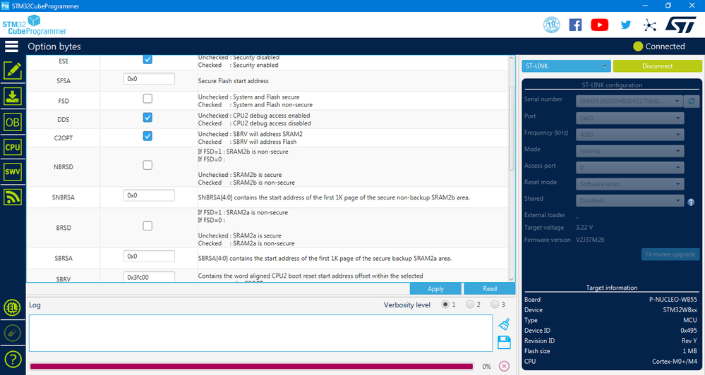

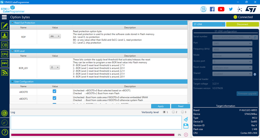

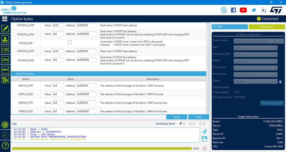

Checking the RM0434 Reference manual the option bytes are ok because are in ST production value, here the option bytes of my STM32WB55 on Nucleo68 board:
I changed the USB cable, put the BOOT0 pin to VDD(3.3V), put the BOOT0 pin to GND and always apears "Error: Data read failed".
In my application I was working with BLE, Standby mode and Sleep mode. How could this happen? Is there a way to resolve this situation?
