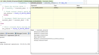

The above call to FragDecoderProcess is from the function LmhpFragmenrationOnMcpsIndication. and the address of the buffer is 0x200078e4. But then in the last call where it hard faults, in the function FLASH_IF_INT_Write, the src address is 0x200078e7:

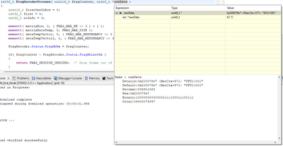

After the call to FragDecoderProcess, inside FragDecoderProcess the address of the rawData variable which should be the same as the Buffer's, is already 0x200078e7:
why would it change? could this be the reason for the hard fault?
