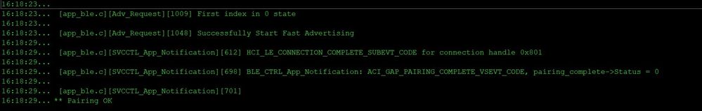

This is how the working p2pserver application logs:

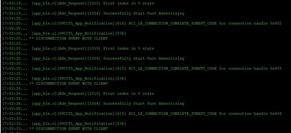

and this is how the failing one logs:
both applications receive the HCI_LE_CONNECTION_COMPLETE_SUBEVT_CODE in function SVCCTL_App_Notification in app_ble.c
but the failing application afterwards comes into the HCI_DISCONNECTION_COMPLETE_EVT_CODE.
The working one comes in the HCI_VENDOR_SPECIFIC_DEBUG_EVT_CODE with sub code ACI_GAP_PAIRING_COMPLETE_VSEVT_CODE
But I cannot relate why. Are these codes comming directly from the ble stack in the RF core M0 processor?
Anyone any tips to figure out what's going wrong. It must be a small thing, because code is 99,9% equal
I am already searching for days why ;(
