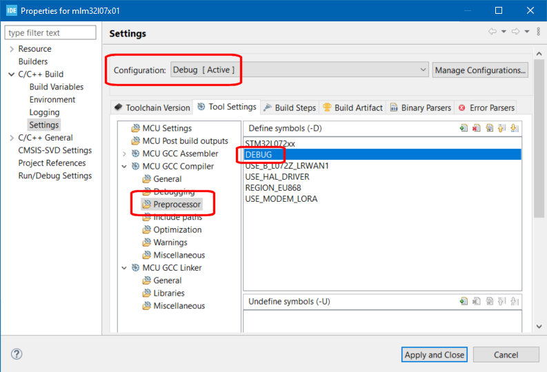

The 'Debug' Build Configuration in the B-072Z-LRWAN1 Ping-Pong example does not define the DEBUG symbol.
This means that you cannot debug the DEBUG configuration!
Who on earth thought that was a good idea?!
:persevering_face:
If you do want to debug, you must add 'DEBUG' to the list of preprocessor defined symbols in Project Properties:

The answer is in the OP: add 'DEBUG' to the list of preprocessor defined symbols in the Project Properties.
