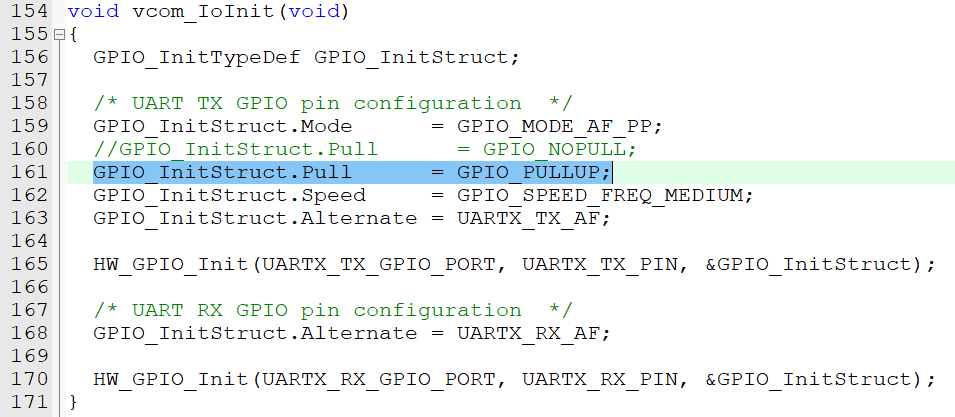

2021-02-10 1:38 PM
Not sure if you solved this issue.
In my case, activating the pullup worked. I modified function vcom_IoInit() of the vcom.c module as shown below
Best,
�?ngel
