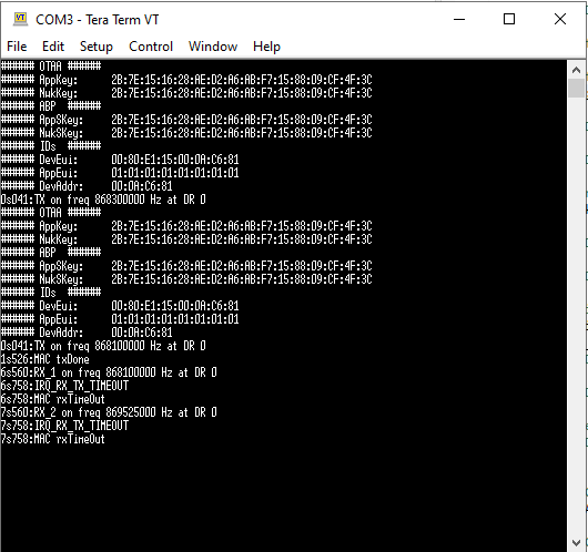

Anyway, this seemed to make the trick, but the code does not still work. When I run it into my board the code stops working before ending the first try to join. See next image:

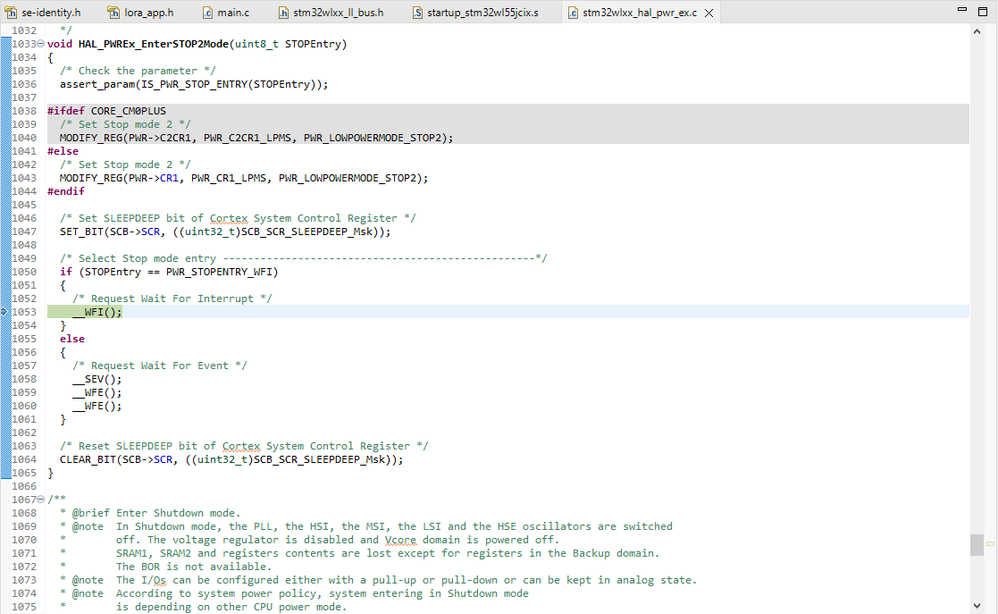

The join failed message never appears and the code is stuck at here:
It seems it is waiting for an interrupt or somwthing related.

Hello @AZube.2 ,
First, you did well to include the BSP driver files.
Concerning the fact your application is not working this may be because you don't have the same code when you generate an End_Node project with CubeMX compare to the exemple given in the package.
In the package we add code that cannot be generate by CubeMX.
I advise you to start from an exemple or if you want to start from an ioc file, compare the difference between the two projects to understand what's missing.
Hope it helps
Regards
