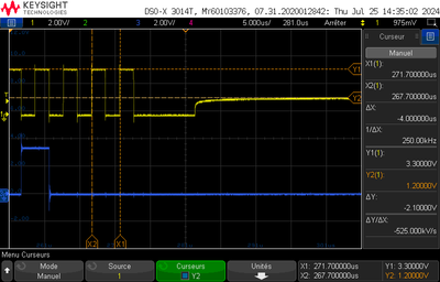

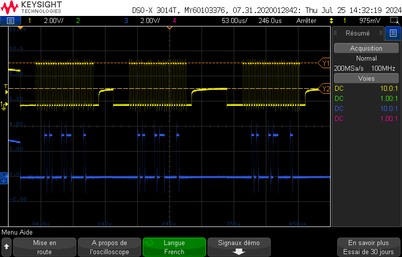

While using SPI1, the clock signal outside communications is at 1.2V instead of th precedent state 0 (0V) or 1 (3.3.V)
as shown in those oscilloscope screenshots:

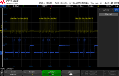

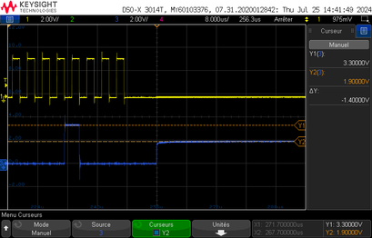

While using SPI3 as I thought it might not show that behavior, another strange behavior appeared, this time on the MOSI signal with a constant voltage when outside com. at 1.9V:
