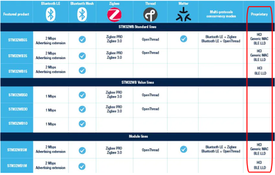

@STTwo-32 wrote:I suggest you to use the STM32WB series that implement a BLE modulation.
Some of the WBs also support some proprietary protocols...
https://www.st.com/en/microcontrollers-microprocessors/stm32wb-series.html
