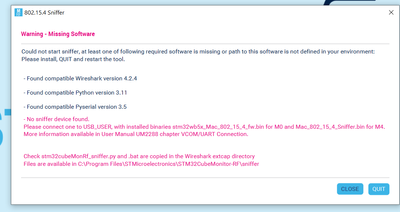

I tried to connect and use 802.15.4 sniffer function from CubeMonitor-RF app. I stopped at the very first step. Once I opened the CubeMonitor-RF program, it said I need to install wireshark, after install the wireshark, the warning message is not changed. What should I do? Also I know how to install the binary stm32wb5x_Mac_802_15_4_fw.bin into the M0 core, however, how I can install the binary Mac_802_15_4_Sniffer.bin? There is no information about the start address for this binary. Do we have to use FUS to install this binary? When I tried to this install with FUS, it failed.

thanks for the information. Yes, I added the path of wireshart.exe to the system variable path and my variable path in environment setting. Now the Wireshark is turned back to black color. I still have two missing pieces.
One is the No sniffer device found. I did install the stm32wb5x_Mac_802_15_4_fw.bin into the P-Nucleo-WB55 board with FUS by CubeProgrammer with correct start address. It was successful. The other bin file, Mac_802_15_4_Sniffer.bin with start address 0x08000000 at Erasing and Programming in CubeProgrammer. It was done quickly.
The other one is about the file copying. I did as it specified, but it is sill red color. I don't know what to do.
Is there a way to find out why this happens?

Regarding the file copying issue, this is not a problem. The indicator remains red even when everything is operational.
Here is the step-by-step method I used to program the WB:
This process was completed using version 2.16.0 of CubeProgrammer, binary files from WB cubefw 1.19 and CubeMonitor RF v2.14.
