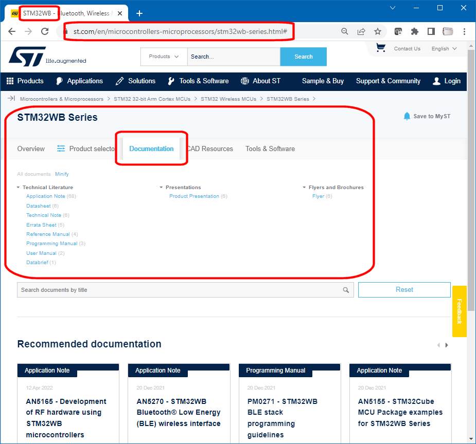

Have you checked out the documentation available?
