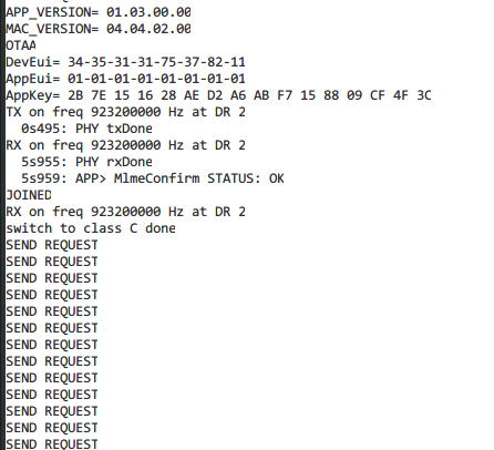

I work with STM32CubeIDE, I-CUBE-LRWAN, Import End_Node Project example, config everything to work on Class C.
Device successfully join to the network, and switch to class C done appears on Serial terminal. But, when the uplink interval comes, and serial terminal showing SEND REQUEST , there is no packet comes to the gateway (monitored over Gateway dashboard from Network Server) while Class A with same hardware and Project Files on STM32CubeIDE works.

Look for "#define LORAWAN_DUTYCYCLE_ON false " in lora.c file. Is it false?
Also write down your "Send" function.
