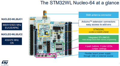

and there's the NUCLEO-WL55JC:
https://www.st.com/en/evaluation-tools/nucleo-wl55jc.html
2024-12-06 6:39 AM - edited 2024-12-06 7:03 AM
The same software compiles and works, not clear what additional "support" you'd need. Most of the original material used the Semtech firmware as a basis, and could be ported to a number of STM32 platforms, where low-power wasn't the only driver. Also other ports on Arduino, and integration with CubeMX as I recall
For quite a while is was more cost effect to find the components individually, or use the Murata based part or DISCO boards using the SX1272 and a 192KB STM32L072. The Murata module was also available on things like the Arduino MKR WAN 1300, also a whole host of REYAX and HELTEC modules too.
The world moves on, and now the functionality has been integrated on the STM32WL models, basically the equivalent to the SX126x

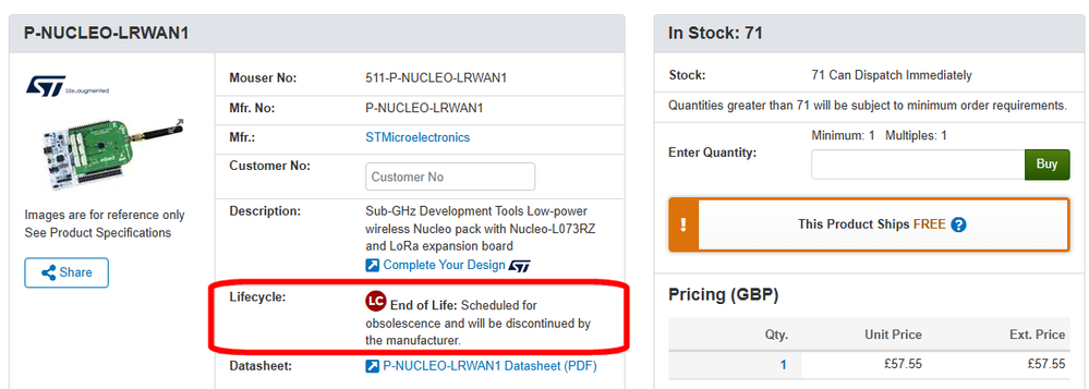

2024-12-06 7:02 AM
P-NUCLEO-LRWAN1, available from Mouser for $71.62
Or
SX1272MB2DAS $31.68
NUCLEO-L073RZ $13.81
$45.49
2024-12-06 7:52 AM
@Tesla DeLorean wrote:P-NUCLEO-LRWAN1, available from Mouser for $71.62
Indeed:
