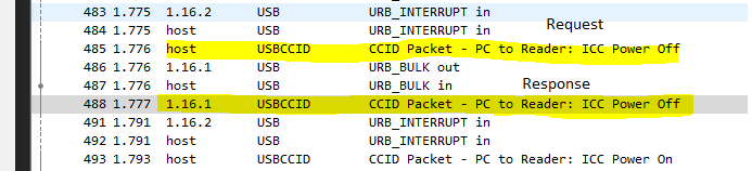

since I wrote this question I have succeeded to create a CCID device. But when i try to send the first frame to the device (frame type : PC to reader ICC power off) i have in response a wrong frame (like an echo) :
I good response should be a RDR_to_PC_SlotStatus frame type according to the CCID standard and the STM implementation.
I have executed step by step the program and all is fine even when i go down in the "USBD_LL_Transmit" function...
Maybe i need to flush somethink before to send a response ?
Thank you.
