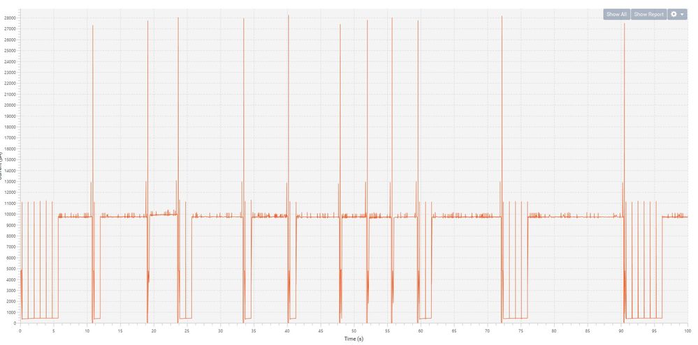

However, when I compiled and ran my project, it stopped advertising after a few packets. I tried to look at the power consumption to find out if I was getting stuck in STOP mode and unable to wake up, but this was not the case. The program was stuck in a loop after an arbitrary number of BLE advertising packets.
Here is a picture of that phenomenon, with spikes corresponding to resets of the device.
To find more details on what was happening, I used the debugger to see what the program was doing, and what I found was that the program was getting stuck when exiting low power mode, more specifically at this line in smp32_lpm_if.c in the ExitLowPower function :
while( LL_HSEM_1StepLock( HSEM, CFG_HW_RCC_SEMID) );
I tried to disable this line, to make it a 2-step lock, but nothing so far has corrected the issue. All other uses of the CFG_HW_RCC_SEMID are in the same file, and are followed not far away by a release of the lock.
In the end, I have not yet been able to find what was preventing the lock operation from being completed, and have no more ideas on what to look for.
