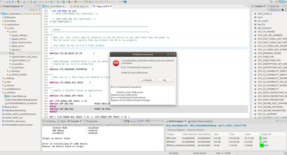

I followed the series of video "STM32WB Getting Started" with my P-Nucleo-WB55 board. During the 5th video "Heart Rate Monitor", I flashed the BLE_HeartRate project into my board and since this I have this message :
"Target no device found
Error in initializing ST-LINK device.
Reason: No device found on target"
I'm on Linux but I tried to do the same thing on Windows and the same error occured. I tried with an other P-Nucleo-WB55 board and I did the same manipulation and the same error occured. I let you screenshot of my errors
Now, I can't flash and run a new code on my two boards. What can I do to reset the Firmware of the board or to solve my problem whereas I can't flash any code on it ?

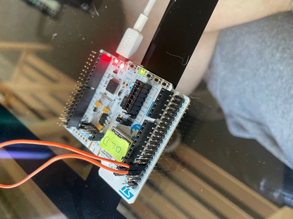

I found a solution : I just connect CN7 pin 5 and 7 (connect VDD and Boot0) and restart my board with this configuration and then I was able to flash a new Firmware.
Thanks to this new Firmware, I can now re-flash what I want.

This means the nSWBOOT option byte was set to 1 to check this PH3/BOOT0 pin to be set to 1.
