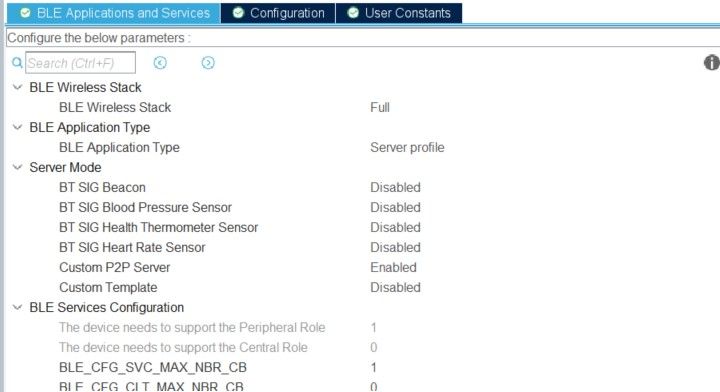

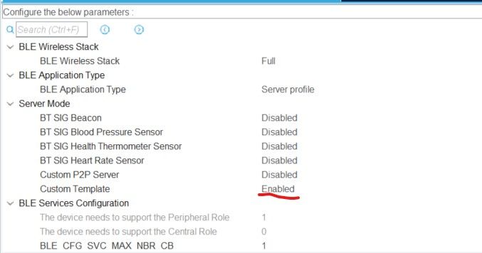

I am trying to build my own BLE application for STM32WB5MMGHx using cubeMX with BLE custom Template , I followed all the needed steps to configure BLE APP the advertising data, services and chars. the projects build but nothing work.
I debugged my projects and I found that I didn't get any interruption on IPCC (RX/TX handlers) after initializing the BLE stack.
I tried also to use the same steps with Custom P2P server and it doesn't work for me and I have the same symptoms.
Is there any specific configuration and setting to make it working.
