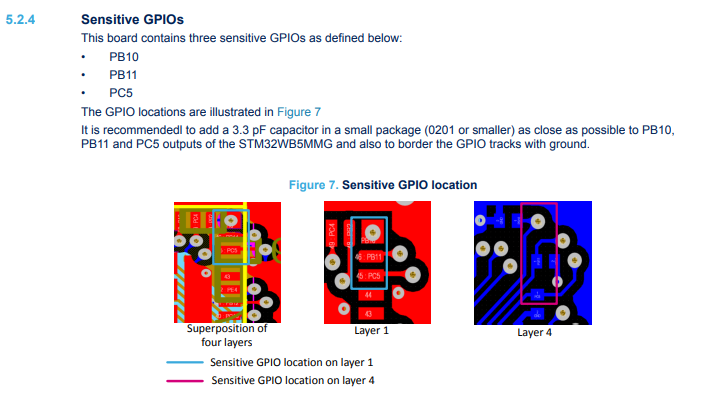

You can try to change the LSE drive setting from RCC_LSEDRIVE_LOW to RCC_LSEDRIVE_HIGH. According to the datasheet on STM32WB5MMG there is three sensitive GPIOS, maybe you used one these GPIOs:
Best Regards
2022-05-18 6:45 AM
I realized that the sensitive GPIOs doesn't have the corresponding capacitors thanks to your answer, however, I use these pins only for an external memory that I'm not using at this moment, so I'm not using them for the communication with any of the sensors (BMI or BMM).
On the other hand, I'm going to try to change the LSE drive, what difference does this change make for the clock?
