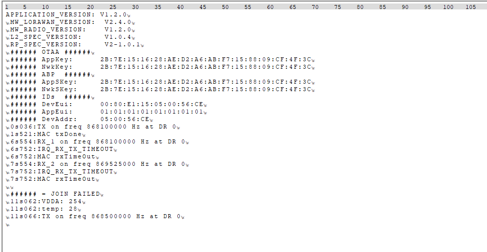

Currently, I am working with an IoT application on the board Nucleo-WL55JC1 with the sensor BME688. The example I am using is LoRaWAN_End_Node downloaded from STM32Cube MX.
What I did: I initialized the the BME688 and set up some configuration after the initialization of MX_LoRaWAN_Init(). I, then, set up some configuration outside the while loop. I "extern"ed the variables below so that I can used them elsewhere:
struct bme68x_dev bme;
struct bme68x_conf conf;
struct bme68x_heatr_conf heatr_conf;Order of initialization are below:
MX_GPIO_Init();
MX_LoRaWAN_Init();
MX_I2C3_Init();
/* USER CODE BEGIN 2 */
int8_t rslt = bme68x_interface_init(&bme, BME68X_I2C_INTF);
rslt = bme68x_init(&bme);
//Set up the measurement
conf.filter = BME68X_FILTER_OFF;
conf.odr = BME68X_ODR_NONE;
conf.os_hum = BME68X_OS_16X;
conf.os_pres = BME68X_OS_1X;
conf.os_temp = BME68X_OS_2X;
rslt = bme68x_set_conf(&conf, &bme);
heatr_conf.enable = BME68X_ENABLE;
heatr_conf.heatr_temp = 300;
heatr_conf.heatr_dur = 100;
rslt = bme68x_set_heatr_conf(BME68X_SEQUENTIAL_MODE, &heatr_conf, &bme);
rslt = bme68x_set_op_mode(BME68X_SEQUENTIAL_MODE, &bme);For obtaining the temperature/pressure/humidity/gas level, I got the data of the sensor in the function SendTxData in the file lora_app.c:
struct bme68x_data data;
uint32_t del_period;
uint8_t n_fields;
#ifdef CAYENNE_LPP
uint8_t channel = 0;
#else
uint16_t pressure = 0;
int16_t temperature = 0;
uint16_t humidity = 0;
uint32_t i = 0;
int32_t latitude = 0;
int32_t longitude = 0;
uint16_t altitudeGps = 0;
#endif /* CAYENNE_LPP */
//EnvSensors_Read(&sensor_data);
del_period = bme68x_get_meas_dur(BME68X_SEQUENTIAL_MODE, &conf, &bme) + (heatr_conf.heatr_dur * 1000);
bme.delay_us(del_period, bme.intf_ptr);
int8_t rslt = bme68x_get_data(BME68X_SEQUENTIAL_MODE, &data, &n_fields, &bme);
float senTemp = data.temperature;
float senPres = data.pressure;
float senHumid = data.humidity;The problem: as in the code, I set the sensor to work in sequential mode, however, the whole setup stopped working after the first measurement. The same thing happened when I set the sensor to work in parallel mode. Sleep mode worked okay and for Forced mode, I could achieve the first measurement before the sensor turned to sleep mode (correct).
Question: Where should I start tracking the problem or how do I fix this problem?
I hope to have responses from you.
Thank you very much, Huy Nguyen.

2022-09-08 9:15 AM
Thank you for your clarification. Right now instead of adding the sensor reading in the middle of SendTxData(). I declared a sensor reading as a function and register it as a task. That task has the same priority as the SendTxData():
UTIL_SEQ_RegTask((1 << CFG_SEQ_Task_LoRaSendOnTxTimerOrButtonEvent), UTIL_SEQ_RFU, RetrieveBMEData);I also did as you suggested: I declared 4 private variables in the lora_app.c namely sensorTemp, sensorHumd, sensorPress, and sensorGas. These variables are updated when the sensor reading function run.
However, the program still stopped working.
Should I continue with this solution (making the sensor reading as a task) but change the priority of the newly declared function? In that case, what should be the priority of this function?
