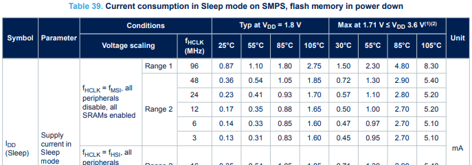

see ds for your cpu, similar :
This depends on the used chip process.
>Is there a way out to reduce the current consumption at high temperature.
no.
or choose other chip / manufac.

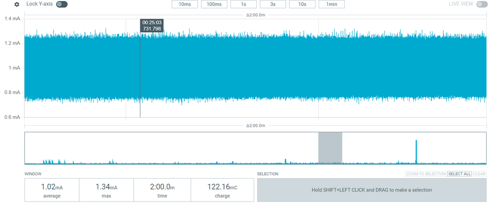

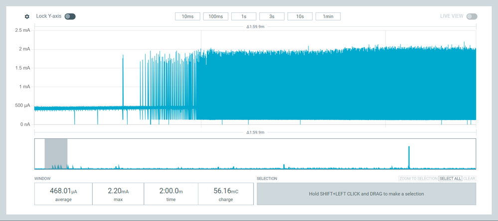

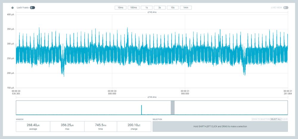

I am using Power Profiler Kit II - nordicsemi.com which can measure upto nA current. The zero ohms R262 is removed and power profiler is connected.
MCU current measurement

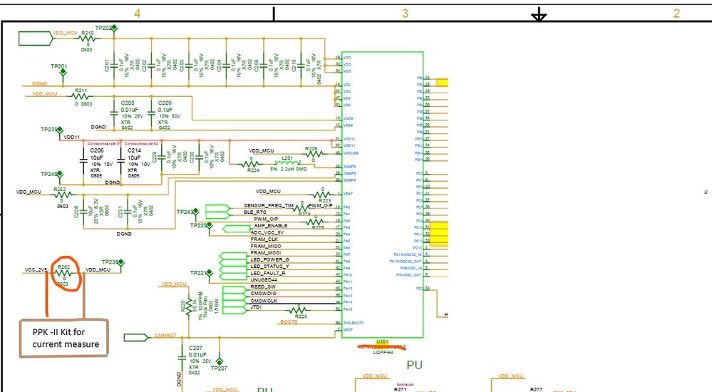

2026-02-23 2:12 AM
That's not the full schematic, is it?
What else is powered from VDD_MCU?
Have you checked the leakage vs temperature characteristics of all those capacitors ... ?

Only MCU is powered from VDD_MCU.
The capacitor used is X7R and has stable dielectric throughout the temperature range.
