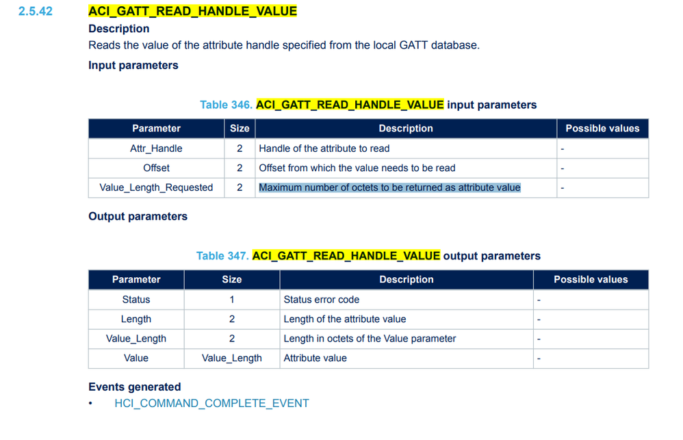

I have created a service and some characteristics with size of 247.
I use 'ACI_GATT_READ_HANDLE_VALUE' to read it and I get some weird response.
Although I requested to read a size of 200, the command returns only 19 .
This is my response packet:
and this is the command response snippet.
I would have expected numbers such as 200 , 247 in the response.
Why 19?
