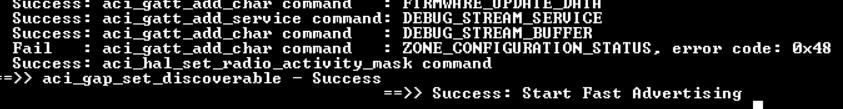

The limitation to 5 characteristics for 1 service comes from STM32CubeMX tool, indeed you can add more characteristics with the aci_gatt_add_char() function, to do this you should increase the Max_Attribute_Records parameter used in aci_gatt_add_service() function. To calculate this parameter follows this formula:
Max_Attribute_Records = 1
+ 2*no_of_char
+ 1*no_of_char_with_notify_or_indicate_property
+ 1*no_of_char_with_broadcast_property
The error code 0x48 means Out of memory.

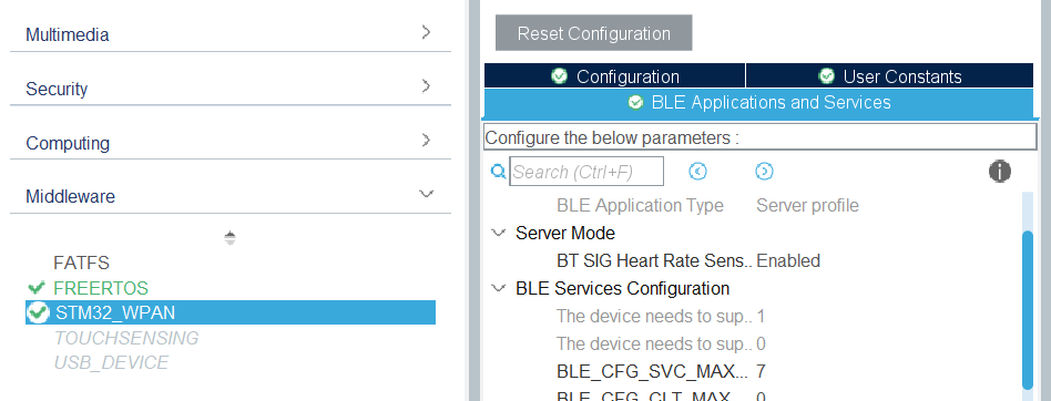

STM32CubeMX tool supports only the SIG HeartRate profile with the RTOS, to port your project on FreeRTOS, you can look the difference between BLE_HeartRate and BLE_HeartRateFreeRTOS.

"STM32CubeMX tool supports only the SIG HeartRate profile with the RTOS, to port your project on FreeRTOS, you can look the difference between BLE_HeartRate and BLE_HeartRateFreeRTOS."
Will STM32 configuration custom templates be supported while using FreeRTOS in the near future? What is the major issue with this... it would seem to be a simple coding of adding a new process for each BLE service needed. Or is there something more complicated going on here?
