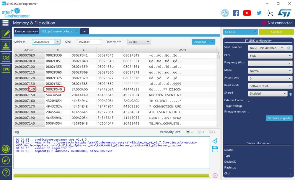

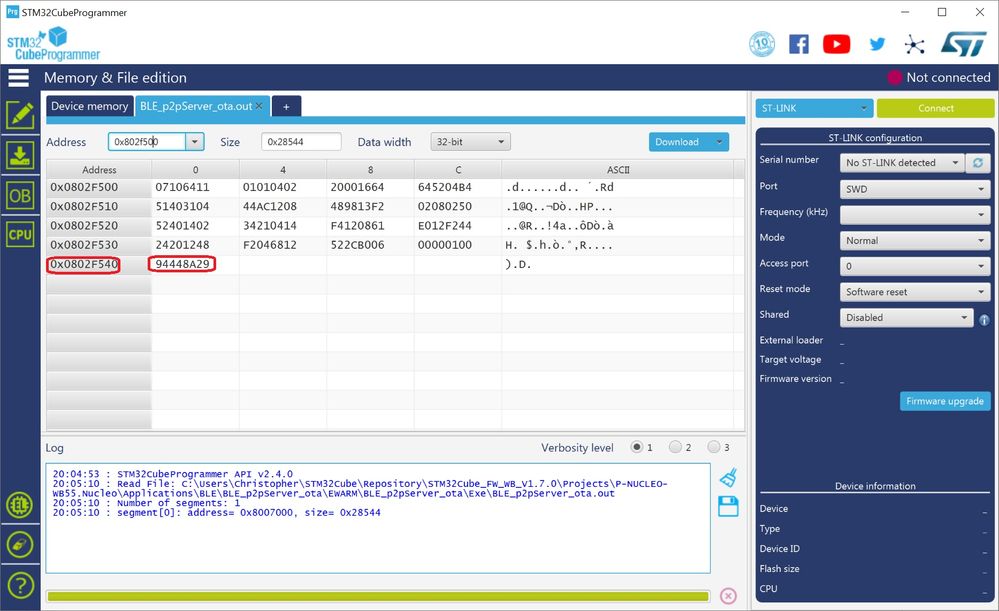

When you create a build the address of the last word in your image is stored at offset 140 in your file. The last word should contain the magic value 0x94448A29 for the BLE_OTA to assume the OTA worked correctly.
But when it failed I noticed the magic number was actually located early on in memory. It seems a BLE packet is lost somewhere so the magic number isn’t placed at the correct location.

Q) Did you check that @0x140 holds the address of the magic word that is expected at the end of the binary ?
A) yes I did. please see attached Stm32CubeProg for confirmation.

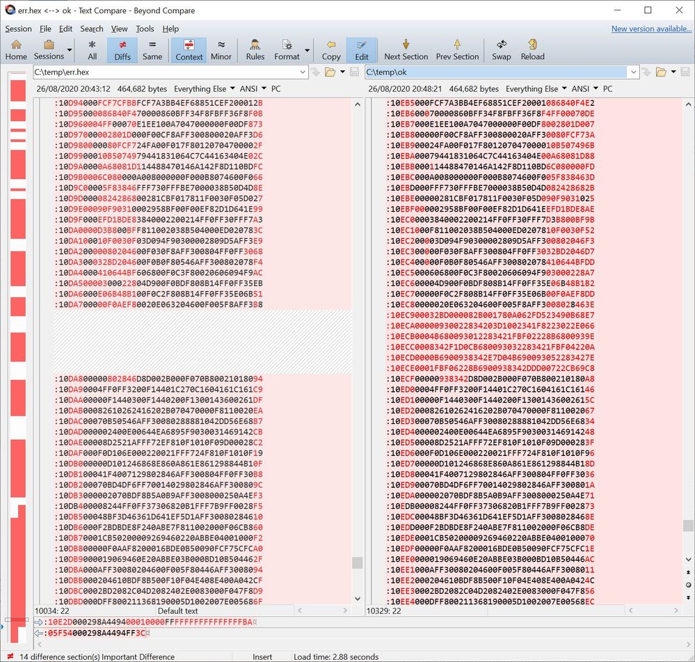

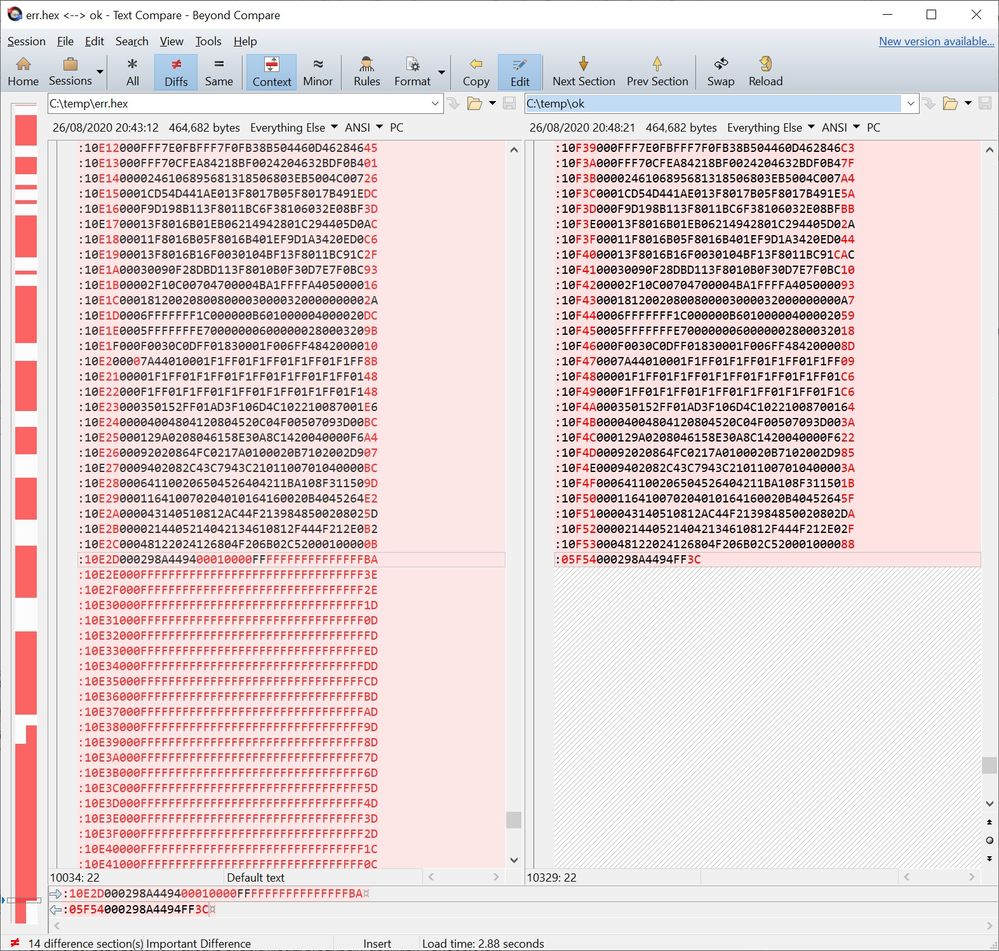

Q)could you please dump back the binary from 0x08007000 to the magic keyword and compare that bin to the one you were expecting to download
A) I compared the correct image with the image in flash after download (but before the OTA erased it due to invalid magic number). Below you can see a missing packet of data on the left side
Below you can see the magic magic earlier on in memory than expected, with the rest being filled up with FFs
>>some data have not been written in flash resulting to the magic word to be shifted earlier in memory
I agree

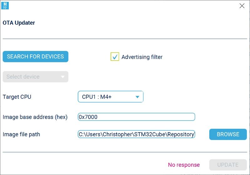

2020-08-29 11:25 AM
Hi Christophe,
I changed the BLE_Ota to include "GATT_NOTIFY_WRITE_REQ_AND_WAIT_FOR_APPL_RESP" which resulted in the STM32CubeMonitor-RF responding with "No response" as shown below
Wouldn't I also need to change STM32CubeMonitor-RF to use the write and response? Also why would adding an extra attribute stop OTA from working.
I double checked I had the correct code by removing my changes and re-testing, and I was back to my original problem.
