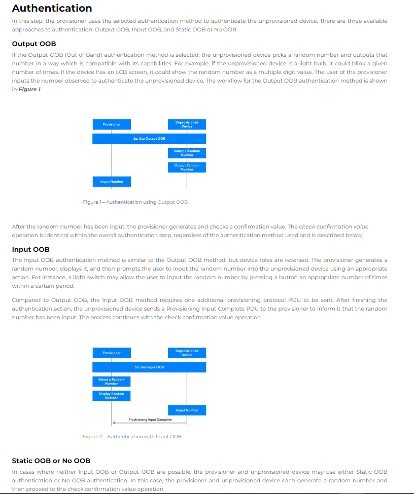

The authentification can be done by BLE if ENABLE_AUTH_TYPE_NO_OOB is defined or by another way "Out Of Band" if ENABLE_AUTH_TYPE_NO_OOB isn't defined. In examples available in STM32CubeWB package, the authentification is done by BLE. See an extract of BT SIG documentation about the authentification:
0693W00000UnPcXQAV.pngBest Regards
