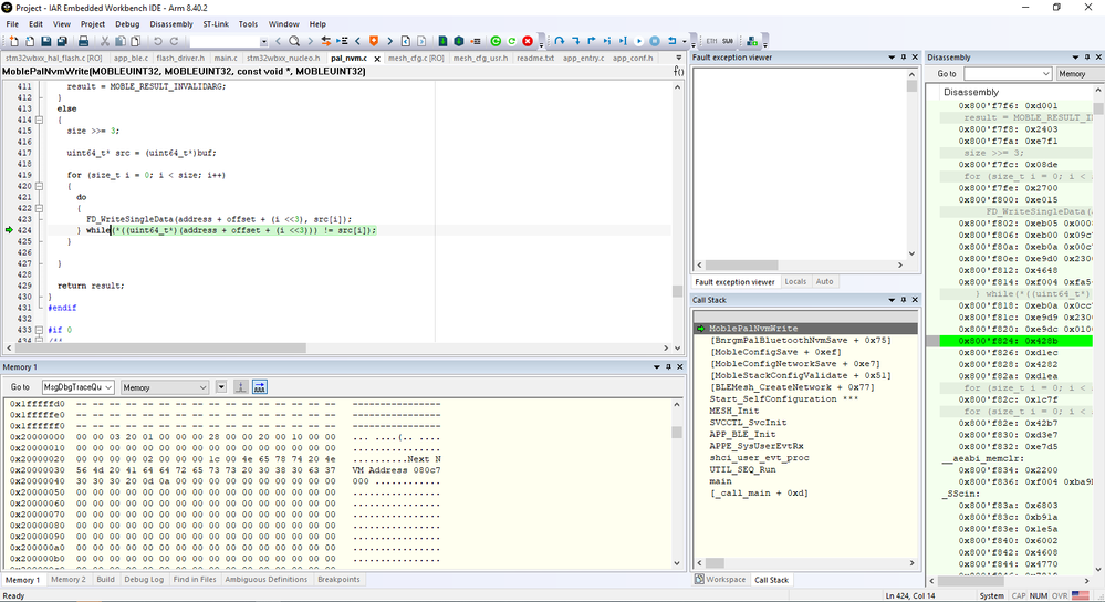

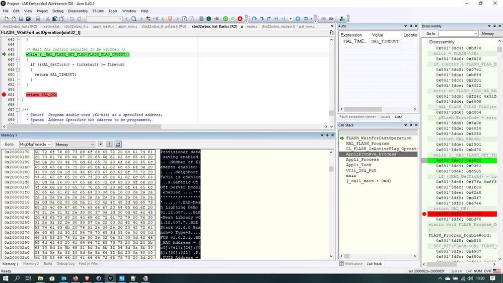

In this example, there is a problem with FLASH access. As can you see on the screenshot AppliPrvnNvm_Process tries to save data but it is always HAL_TIMEOUT.
After more tests I can see when microcontroller is fully cleared (RDP -> 0xBB -> 0xAA) this function works properly and returns HAL_OK.
But after reset there is always HAL_TIMEOUT returned.
The next problem with FLASH access is that I can not write my data to FLASH.

}I also call SHCI_C2_SetFlashActivityControl(FLASH_ACTIVITY_CONTROL_SEM7); at the end of void APP_BLE_Init( void );

/* USER CODE END FD_WRAP_FUNCTIONS */On the screenshot you can see endless execution do {} while() because of flash write fails.
From this forum I know that there are problems with FLASH access in examples based on BLE. But in mesh write to FLASH does not work at all.
Anyone plays with BLE mesh and deal with this issue?
