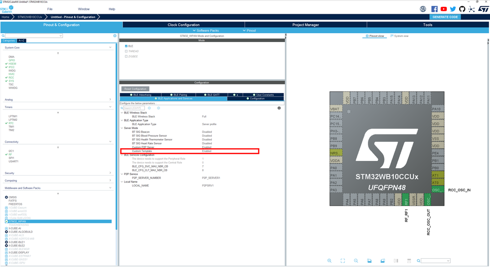

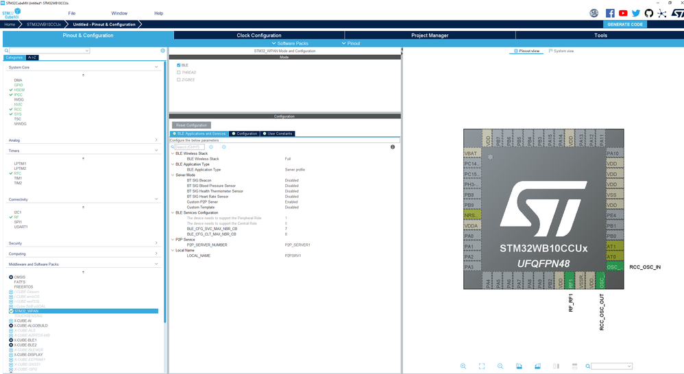

If you want to remove the GATT Attribute Service from your STM32WB device, you can follow these steps:
1- Open your STM32CubeMX project.
2- Disable "Custom Template option "
3- Save the changes and regenerate the code .
Thx
