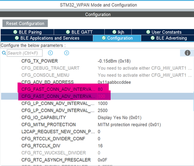

Hello @Nico3
Just as a clarification of what started @kumaichi , you can control the Connection interval throw the CFG_FAST_CONN_ADV_INTERVAL_MIN and CFG_FAST_CONN_ADV_INTERVAL_MAX available on the app_conf.h file of your project or throw CubeMX directlly:
Best Regards.

2025-03-25 1:18 PM
Sorry if I join this thread with a follow up question.
The parameter that you suggest to change is related to the connection interval when the device communicates or is the connection interval during the advertising phase?
