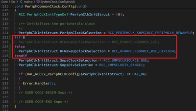

I have the same problem when run the examples on P-NUCLEO-WB55 MB1355-D01, such as BLE_HeartRate and BLE_p2pServer in STM32Cube\Repository\STM32Cube_FW_WB_V1.16.0\Projects\P-NUCLEO-WB55.Nucleo\Applications\BLE.
I have confirmed that LSE was ready by lSCO pin. After modifing the code ccording to the picture above, both BLE_p2pServer and BLE_HeartRate can work.

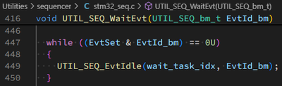

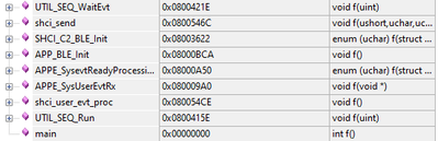

Here is the stack when using the LSE as a source clock for the RFWKP Clock.
It trapped in while loop:
