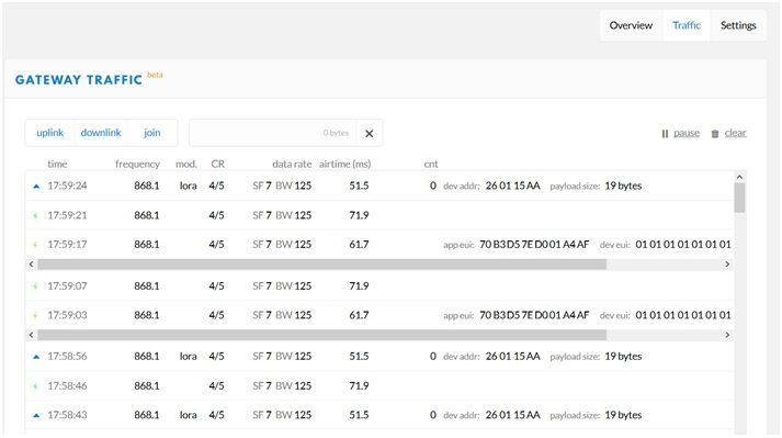

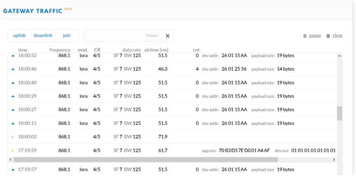

Hi, first my node did not get the join response and continuosly sent the join request but “suddenly�? my node started to sent the join request and got the join request accepted but repeated the process
i mention “suddenly�? because it started to work just when i moved my gateway, then after a few minutes i moved my node antenna toward my gateway and it worked!
I am very confused because yesterday i read in a post that the devices (gateway and node) must not be too close then i moved my gateway away from my node and it works then i disconnected my node and when was started once again just sent the join request, i had doubts about the distance between devices but today i confirmed it is the problem but the solution is very random because sometimes works and sometimes doesnt works, any suggestion?

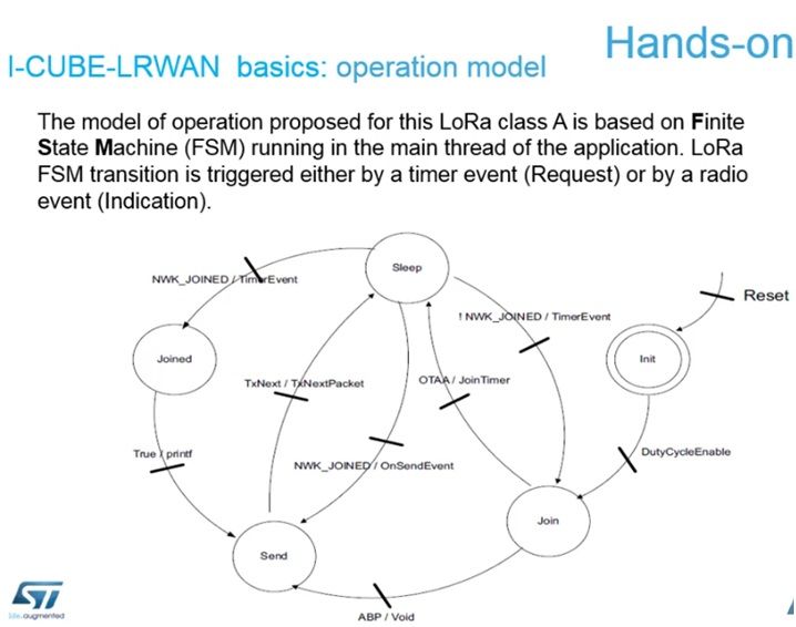

***in the number guessing example is implemented a finite state machine to join the network, and i think that the problem could be the JoinTimer that starts counting when i go from the Join state to Sleep state, i think that somehow this timer produces a timeout and the finite states machine returns to the Join state and repeats this but i dont have idea how to change that timer.

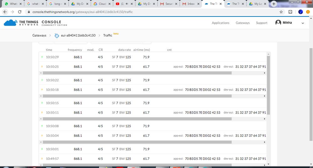

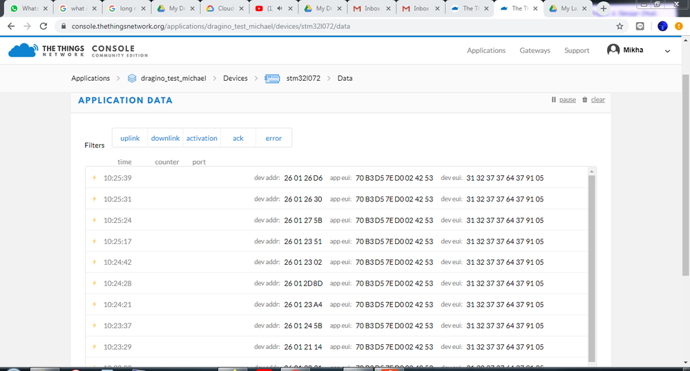

2019-12-12 2:45 AM
I got this problem too. i'm using
and the result almost same for this case, but mine donwlink and uplink are not happend. when i set the frequncy difference(like 923 MHz) nothing happend(join request&join accept) on my TTN.
I need the explenation too..
Thanks
2019-12-12 10:44 AM
configure the node using ABP, it seems like dragino is a single channel gateway too and it gives a lot of problems using OTAA (I don't know exactly why but is because just can receive only in one frequency), so I developed my project with ABP
