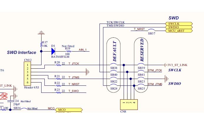

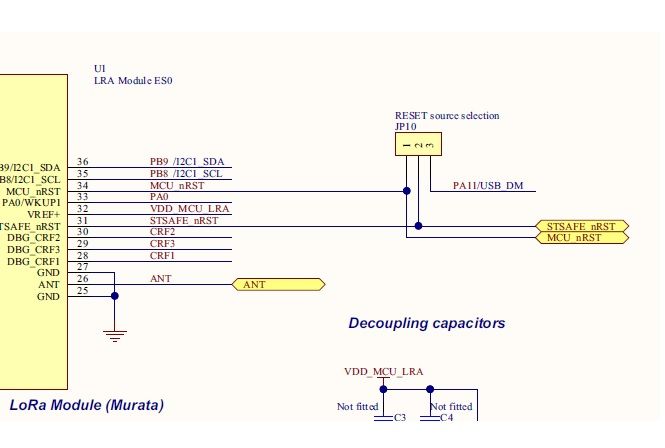

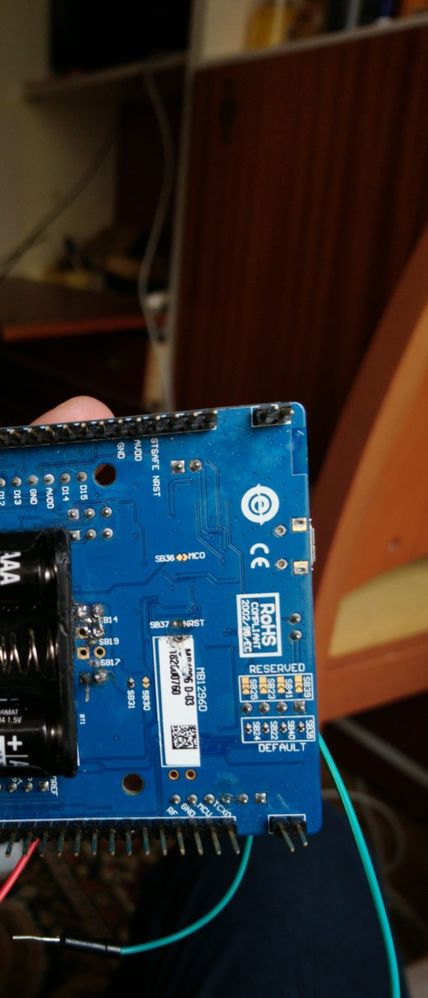

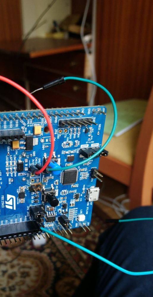

*I haven't read in your posts about this solder bridge but the datasheet specifies that if you want to power the board from cn13 you must remove sb26, option 1 is the best way to measure the currents because when you disabled sb26 it isolates all the regulators, modules, etc, and the diode D2 which consumes power from batteries
**it is not necessary to weld again SB37 to reprogram the board, if we look the datasheet of the board the pin #1 of JP10 is the reset of the MCU and pin #5 of CN12 is the reset signal from st-link so you could join them with a cable and re program the board, it fails sometimes but generally works
