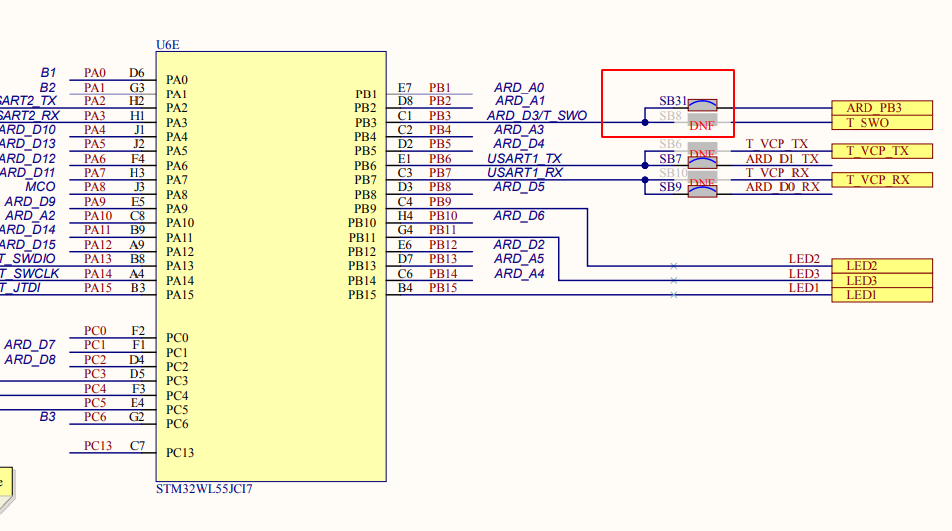

Yes, the clock was indeed 48 MHz, and basically also sending strings without newline works. I think I found the reason.... if I read the schematics and board specs correctly, the PB3\SWO pin of the MCU is simply not connected to the ST-STLink... solder bridge SB8 (chapter 6.7) is open per default and thus PB3 is used as an alternate pin for timer 2 (TIM_CH2)
