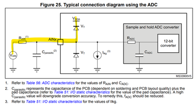

Just one last thing to be absolutely sure - where you said " 2.5V is maximum input voltage to ADC too" - this you mean the maximum volts to avoid ADC saturation, correct? But the pin can still withstand more volts as follows from datasheet:
I am using PA0 as the ADC input (ADC_IN0).
From datasheet (STM32G071RB) this is listed as FT_a IO structure.
My VDD and VDDA is 3.3v
Under 5.2 absolute max for FT_xx is VDD+4 so 7.3
Under 5.3.1 FT_a has a max of min(vdd+3.6,5.5) so min(3.3+3.6,5.5) = 5.5
So if I design my current sensing region of interest to max out at 2.5v if a higher current happens and puts PA0 pin above 2.5v but below 5.5v the only result is ADC saturation and not chip explosion.
Thank you once again
2024-03-13 4:16 PM
That's correct as far as I can see.
There are protection diodes in place. I suspect the following figure is simplified, but shows the general scheme.
Personally, I wouldn't want to design something with inputs above VDDA, but I can't see this concern being justified in the datasheet.
2024-03-14 4:25 AM - edited 2024-03-14 4:26 AM
Most probably not, and you should stay below VDDA.
I've started a new thread to request clarification from ST for this issue. Pending relevant reply, I'd consider pins used for ADC or any other analog functionality as max.-VDDA, regardless of the fact they are FT.
But, as you've said, if the ADC input is between VREF+ and VDDA, ADC will overflow but won't explode :‑)
