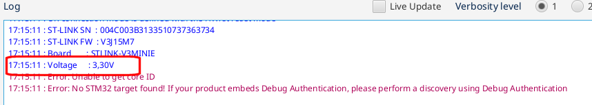

I try to connect with cube programmer and V3miniE.
here is the log :
is there a procedure to connect to board ?

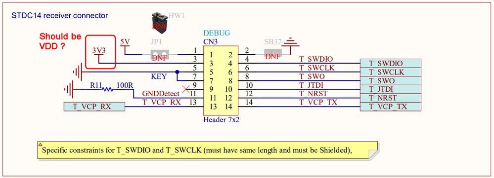

@aweber_schaller wrote:Looks like you have removed JMP2!
If jumper removed, the VDD is disonnected from 3V3 so the STM32WL5MOCH6S has no power!
That seems like a really poor design choice on the debug connector:
So the debug probe will report that the target has power - when it doesn't!
As shown in the OP:
