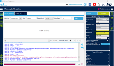

i'm trying to work with Sigfox and MB1779B board.
I try to connect with cube programmer and V3miniE.
here is the log :
is there a procedure to connect to board ?
thank you

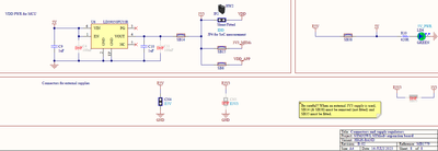

2025-02-12 1:33 AM - edited 2025-02-12 1:37 AM
Looks like you have removed JMP2!
If jumper removed, the VDD is disonnected from 3V3 so the STM32WL5MOCH6S has no power!
JMP2 can be used for current measurement.

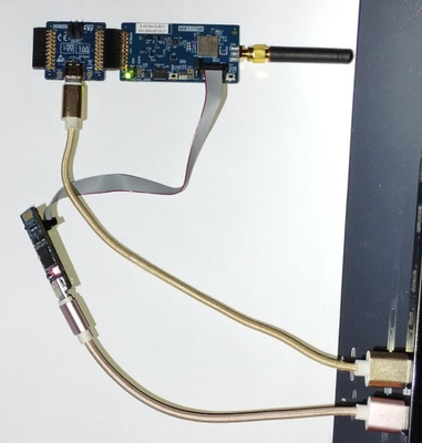

2025-02-11 8:41 AM
Please show your wiring between the V3miniE and the B-WL5M-SUBG1 (MB1779B).
2025-02-11 11:34 AM
2025-02-11 2:54 PM
are you sure you have that ribbon cable the correct way around?
2025-02-11 10:59 PM
it's a foolproof device, isn't it ?
i'm working with a lsm100A, and it's ok.
thank you, I'm going to check wiring

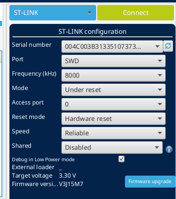

2025-02-12 12:36 AM
Try using "Hardware reset" - the default setting is "Software reset"
2025-02-12 1:14 AM
this is my conf :
2025-02-12 1:16 AM
I've tried differents Modes....
