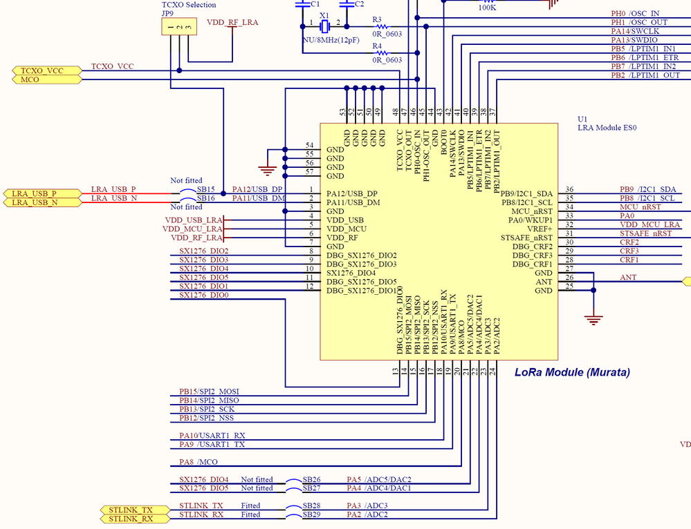

Literally all of the pins on that chip are used. Something needs to go there, where else would you put it? A lot of the other potential pins are peripheral-specific and would suffer the same drawback. Probably not a specific choice but rather an artifact of what pins were left over after everything else was routed.

Ah yes, that's true for the B-L072-LRWAN1 (which, of course, is what I asked).

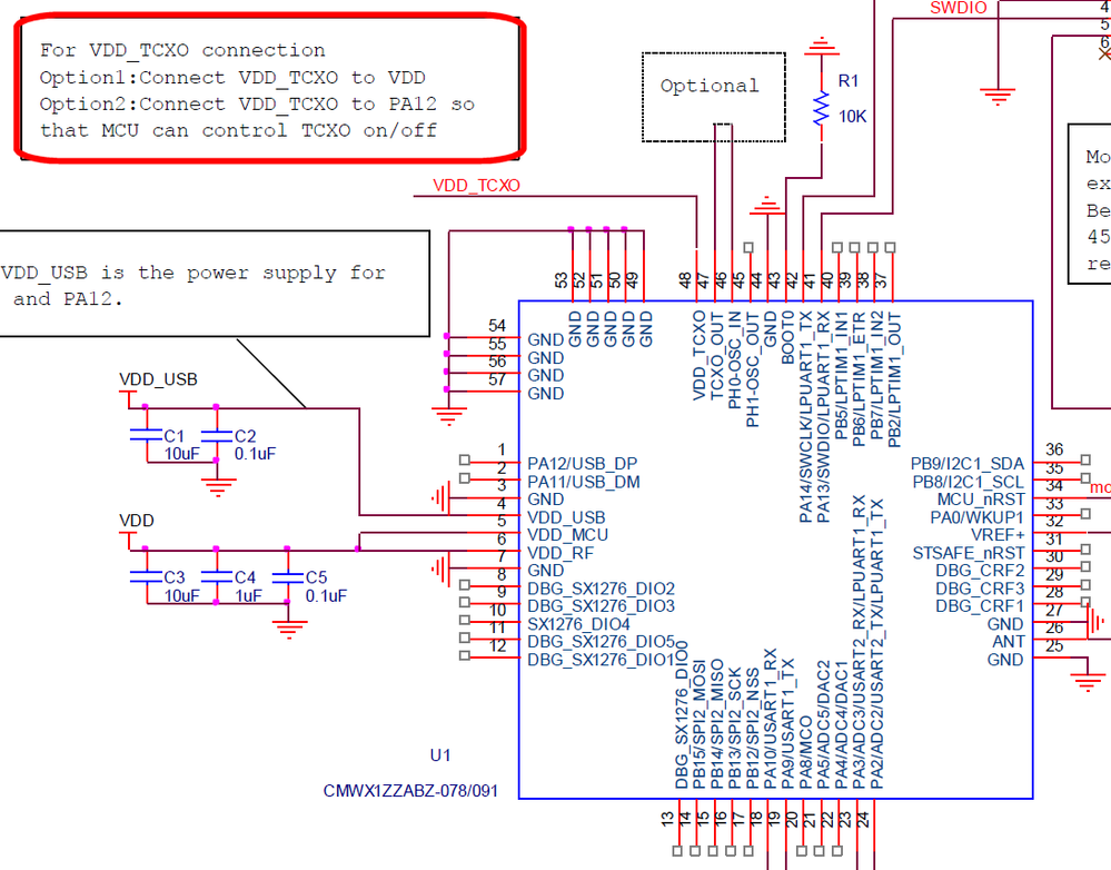

However, Murata have it in their "reference circuit" - where the majority of connections are uncommitted:
but maybe their reasoning was the same?

Hmm, it could be. Or perhaps they just copied what ST did without thinking? Or maybe to have it be driven from a voltage other than VDD? Can't think of any other reason to have it like that.
