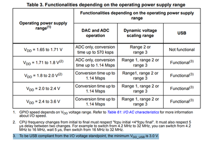

I’m using an STM32L052 with LQFP32 package, VDD = 1,8V.
According to the datasheet:
VDD_USB = 1.65 to 3.6V: external power supply for USB transceiver, USB_DM (PA11)
and USB_DP (PA12). To guarantee a correct voltage level for USB communication
VDD_USB must be above 3.0V. If USB is not used this pin must be tied to VDD or VSS.
On packages without VDD_USB pin, VDD_USB voltage is internally connected to VDD
voltage
Since in the LQFP32 package VDD_USB is internally connected to VDD, it is therefore powered at 1,8V in my design.
As expected, the USB interface does not operate when I connect the board to a PC and risk of damage because D+ and D- tied to 1,8V
Could you please confirm that the internal USB PHY cannot operate correctly at 1,8 V, and that USB operation requires VDD ≥ 3.0 V even when VDD_USB is internally tied to VDD ?
If so, what would be the recommended workaround for designs that operate the MCU at 1,8 V ?
Thanks in advance for your clarification.

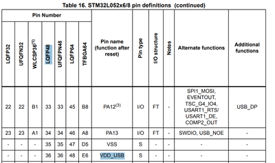

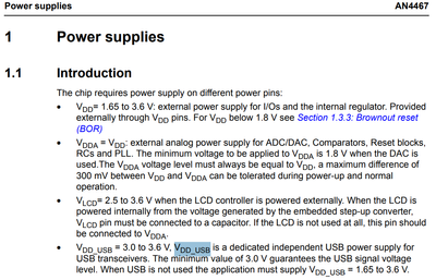

Sorry for hearing that! Indeed, USB PHY cannot operate at 1.8V. I'm escalating this to dedicated team. It is mentioned in page 18, to be USB compliant from the I/O voltage standpoint, the minimum VDD_USB is 3.0 V. also in hardware getting started app note.
The only workaround I see to use different package STM32L052 C6/R6/C8/R8. I mean LQFP48 would be less expensive.

Thank you for your reply.
So I have two Options :
1- Change the package to one who VDD_USB is pin accessible
2- Change system voltage (VDD)  to 3,3V (3,0V Minimum)
okey, need recalculations
