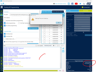

I flashed this firmware on board:
after programming it shows this:
nothing is running.

first of all, which core is locked? I was programming with STM32WB chip, so I think it should be this core. M4 or M0? The parts 3.2.24 and 2.4.1 of the UM2237 are commands specific for STM32WL

I have a similar problem.
- Astra1b is attached to PC via ST-Link mini.
- Build the debug Logistics application example using CubeIDE.
- Erase the chip's memory using Programmer. Reread it back and it is all FF's.
- Flash the STM32WB on new ASTRA1B board using Programmer.
- Programmer indicates target is WB5x core, and not the WL5x LoRa core.
- Partway through flash the message "core lock up" appears as depicted below.
- Reread the memory and it looks like the flash worked.
- The chip does not do anything other than blink a yellow light next to USB connector, which is was doing before flash. No activity on virtual COM port.
- Setup used successfully to flash WL55JC Nucleo board.
Any ideas.
2023-11-19 4:13 PM
The problem was apparently due to a bad USB cable. I replaced the cable and the problem went away. I can now flash the device.
