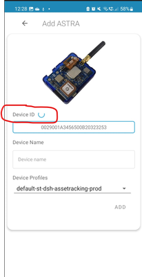

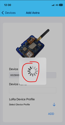

I´m doing my first try with the board STEVAL-ASTRA1B, try to run the example binary for Logistic.
LoRa can not join the network:
on the APP ST Asset Tracking there is no data from GPS:
some hints? Thanks in advanced.

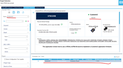

2023-07-21 12:16 AM
Hello again,
I suggest you to use the CustomUC application with the last version of CubeMX for your application.
When your question is answered, please close this topic by choosing "Accept as Solution". This will help other users find that answer faster.

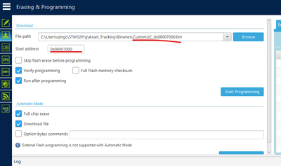

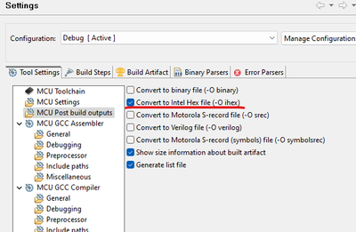

Sorry, I´m a newbie to ST development environment, as I understand CubeMX is for generating code and it is in CubeIDE integrated, so I just use CubeIDE and import the CustomUC project like this
with this setting I get a hex file
after flasing it in the board, nothing happens. No USB connection, No any LED blinking, it seems nothing is running.

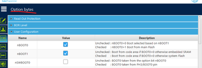

another question: I´m a little coufused about these three settings
how should they look like before and after flashing new Copro_wireless_binaries? should I change them manuallly if I flash another wireless stack, or the software handles them automatically?
BR

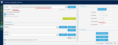

2023-07-27 12:25 PM - edited 2023-07-27 12:27 PM
Hello again,
After doing a full chip erase
here is how I flash the wireless stack and the CustomUC binary, and the output.
everything seems successful, but nothing is running.

21:23:11 : Memory Programming ...
21:23:11 : Opening and parsing file: CustomUC_0x08007000.bin
21:23:11 : File : CustomUC_0x08007000.bin
21:23:11 : Size : 277.34 KB
21:23:11 : Address : 0x08007000
21:23:11 : Erasing memory corresponding to segment 0:
21:23:11 : Erasing internal memory sectors [7 76]
21:23:12 : Download in Progress:
21:23:16 : File download complete
21:23:16 : Time elapsed during download operation: 00:00:05.657
21:23:16 : Verifying ...
21:23:16 : Read progress:
21:23:17 : Download verified successfully
21:23:17 : RUNNING Program ...
21:23:17 : Address: : 0x08007000
21:23:17 : Application is running, Please Hold on...
21:23:17 : Start operation achieved successfully

Double-check that you are flashing the correct versions CustomUC binary.
Try resetting the device after flashing the firmware. Sometimes a reset is necessary to start the firmware running.

2023-07-30 3:42 AM

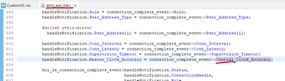

Hello again,
this time I recompiled the CustomUC code by myself, there was an error in :
it was Master_Clock_Accuracy.
After I flash the device with new binary file, it seems working.
But the mobile app ST Asset tracking hangs, the device can not be added succecssfully.
I tried both android and ios version
Thanks and Best regards
Danny
