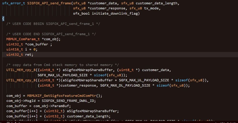

So I tried to run the code but no signal from Sigfox came out. I was confused by not having a prototype like the dual core version has. As shown in the figures below.
Here we can see the prototype of the SIGFOX_API_send_frame() function. But this only exists in the dual core example. The single core has no prototype of this function, and I don't see any signal coming out of the board when I run the AT_SLAVE or PUSHBUTTON (SINGLE CORE) example

The SIGFOX_API_send_frame() is a direct API to Sigfox library, you can find its definition in Middlewares\Third_Party\Sigfox\SigfoxLib\sigfox_api.h
The SIGFOX_API_send_frame() you are displaying is not the mplementation of the routine, but only a function created in Dual Core project only, in order to allow CM4 (application core) to ask CM0 (containing Sigfox radio stack) to send the frame.

The function of your printshot shows the dual core is a mailbox wrapper.
In dual core the Sigfox library runs on CM0PLUS.
In order to call that function from CM4 the dualcore projects implements a mecanism called MbMux, where the actual function is replaced on CM4 by a wrapper that send a message to CM0PLUS to tell to execute that function.
This allows CM4 application to be the same (same function calls) in single and in dual version ....
