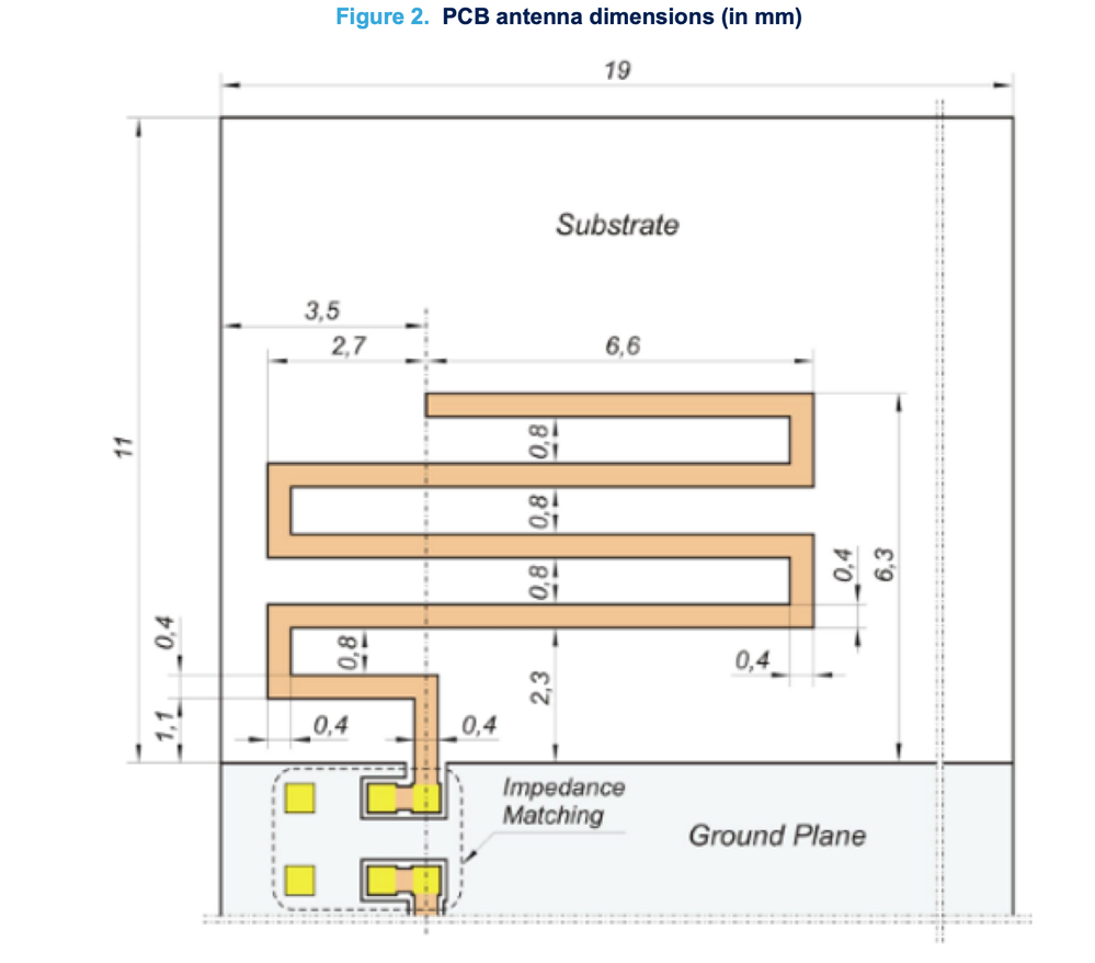

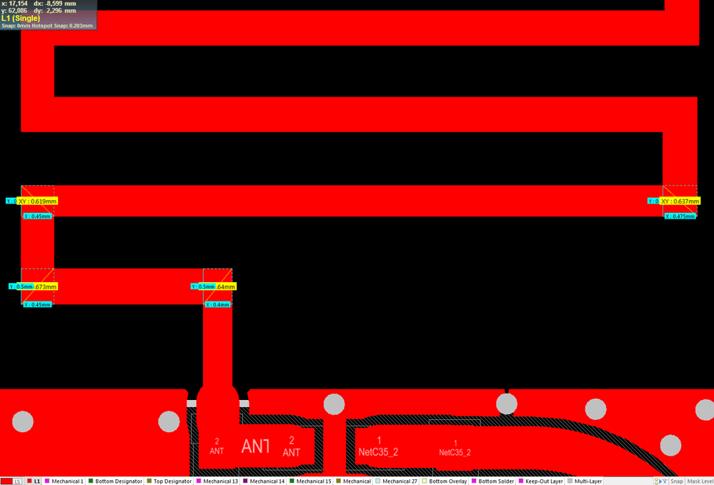

I'm wondering about discrepancies in antenna dimensions between AN5129 application note and the actual board - Nucleo MB1335. As you can see the differences are subtle but visible. I'm mostly curious about why the antenna width varies? Widths at different spots I was able to measure: 0.4mm, 0.425mm, 0.45mm, 0.475mm, 0.5mm.
Also, the gap between parallel arms varies between 0.725mm and 0.75mm, which is different than 0.8 specified in the app note.
Is there a reason for that or is it simply a mistake while doing a layout? I can see that the antenna wasn't defined as library component but rather drew as a polygon.

Just got the answer. In fact, this layout came from a previous design for which the antenna was fully validated for BLE communication. Some marginal adaptations were made after further tests on the first proto boards as it is hard to determine the exact parameters of the PCB.
Note that the width of the antenna has an impact on the impedance, radiation and bandwidth too. hence the differences you can see in between the theorical design in AN5129 and the effective design resulting from real tests.

I didn't measure the actual board. The differences are on the design files, based on which the board is later manufactured.
