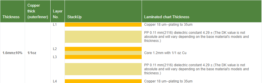

The design Stackup is here:

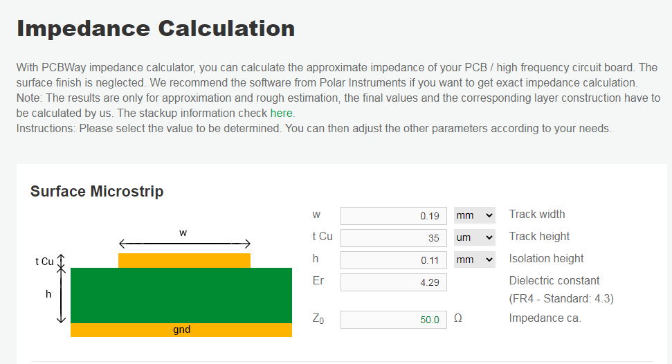

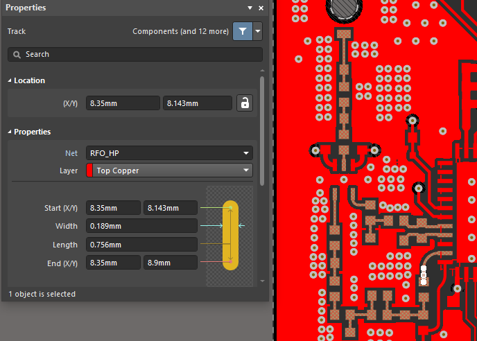

impedance trace width according to our PCB manufacturer (PCBWay) are here:

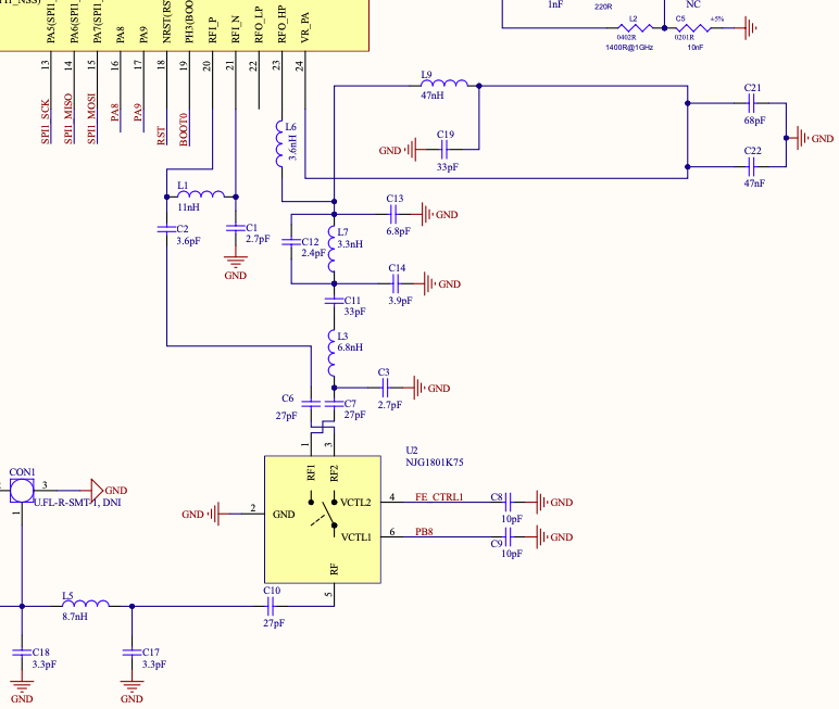

We made an RF network using the following reference:

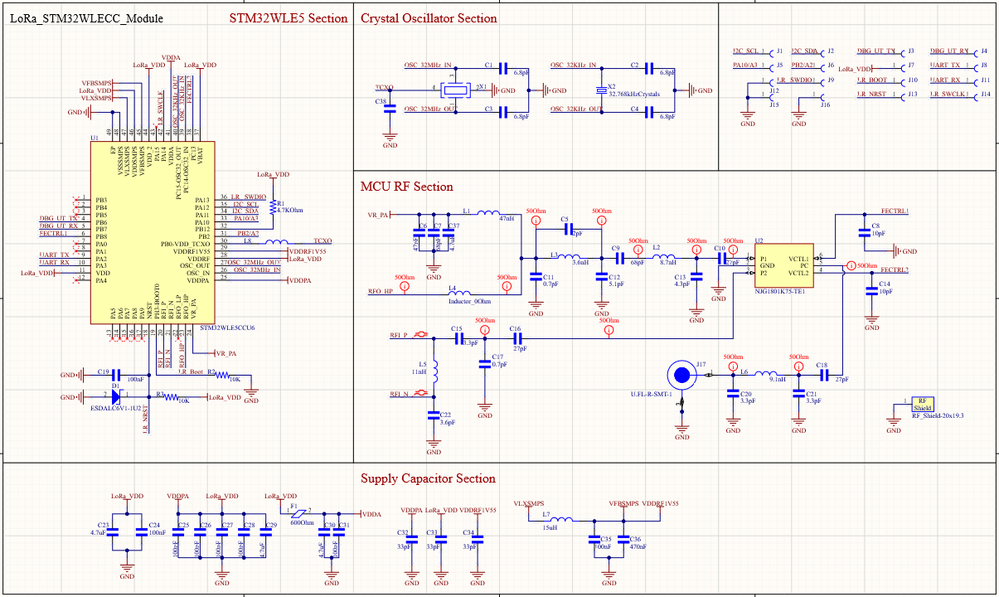

The schematic of my design is shown here:

2) Is our RF network design OK or do we need some changes in our RF network peripheral values?

That they work together suggests it's a frequency issue.
What on earth is going on with your TCXO circuit? It makes no sense, you have it wired like a crystal.
You should only need OSC_32MHZ_IN connection to STM32.
Check/confirm frequency.
State specific part used for TCXO, provide link to data sheet.
2023-06-12 12:36 AM
2023-06-12 2:29 PM
Omit L8 / C38, pin 2 / 4 on the XTAL should be ground, you have one of those pins connected, so should go via the case.
Validate the frequency. If you can escape via MCO / PA8 pin or similar.
Or divide as MCU clock via one of the TIM.
Make sure the HSE clock starts, and HSE_VALUE reflective of the frequency.

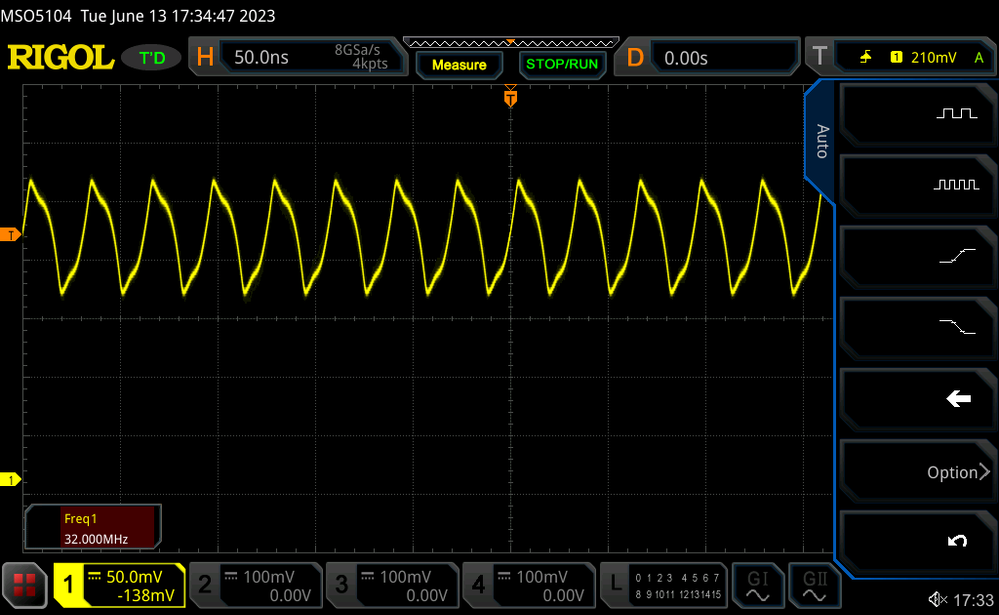

In our design, we do not use TCOX xtal. The L8 was the Do not Place (DNP) component. and the x'tal pins 2 & 4 are internally connected.
We tested the HSE clock on PA8/MCO pin and got the 32MHz clock. I have shared the waveform.

The waveform looked fine as I recall.
