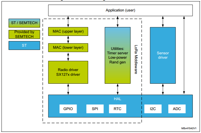

I'm not sure where Semtech's and ST's code begins and ends, but it ends up a bit of a Frankenstein's monster fitting the pieces together and using the RTC as a time base to keep the power low. There are more concise SX1276 code implementations, so it is helpful to get familiar with the chip itself and how it fits into the abstraction/implementation.

Is there actually any documentation anywhere of the code structure ... ?
Please refer to
http://www.st.com/resource/en/user_manual/dm00300436.pdf
and mainly ''Architecture'' paragraph where you find this figure:-Amel
