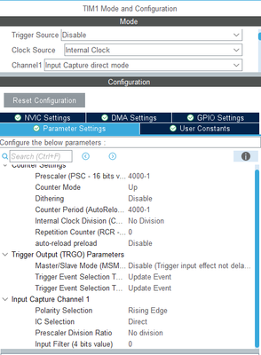

I did a further test and it turned out that the timer is not working properly. Here is what I did:
1. I initiated a timer with interrpt and created a counter variable to check elapsed periods:
uint16_t TIM_counter = 0;
HAL_TIM_Base_Start_IT(&htim1);
3. In period elapsed ccallback function, I increment my counter variable everytime a period elapses:
void HAL_TIM_PeriodElapsedCallback(TIM_HandleTypeDef *htim)
  TIM_counter ++;
On nucleo-wb15cc, the counter keeps increment with defined interval. But on my custom board with stm32wba54kgu6, the counter flashes between 1 and 0. It looks like the timer is being reinitialized constantly. This is my timer setup for both stm32wb15cc and stm32wba54:
I wonder what difference between stm32wb15cc and stm32wba54 is causing this problem and how to solve it?
Thanks and best regards!
